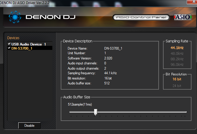

In the picture you can see the problem its not the decks or drivers as i have swapped them around to test it I have looked at the advice above and not really sure what I should be doing and very cautious about removing anything as I dont have the knowledge to do :(

You really did not answer the guys question about the "types" of usb ports. You have 3 usb ports. Are they all usb 3.0 ports, all usb 2.0, or a combinations of the two?
Posted Thu 05 Feb 15 @ 1:34 am
You should also try different cables. This is a generic error that Windows fail to establish proper communication with your device.
It might be a communications issue, or it might be a Registry issue.
If you are not aware of it, Windows keep a "history" of all the devices connected on your ports. If the history of one deck/port is scrubmled then you won't get the deck working properly again until you remove the faulty entry from your registry.
There are 2 ways to do that: 1) Format your PC, 2) Use an application that does exact that!
Posted Thu 05 Feb 15 @ 5:12 am
