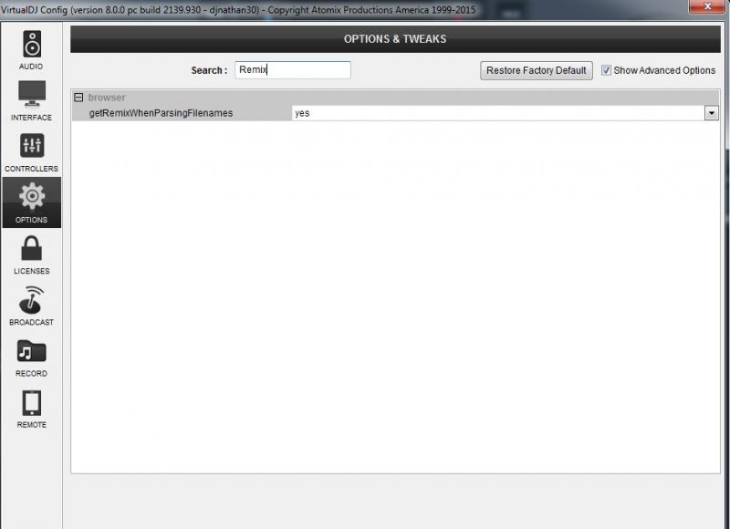

In config/options, is getRemixWhenParsingFilenames on or off?

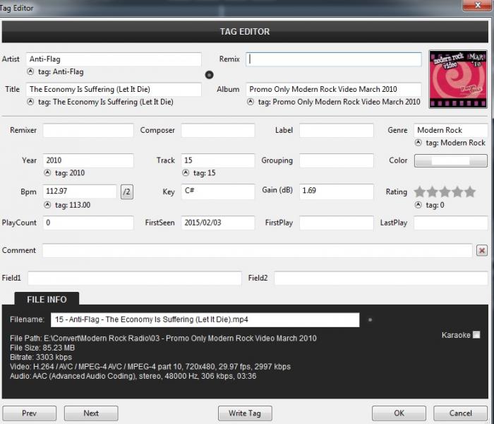

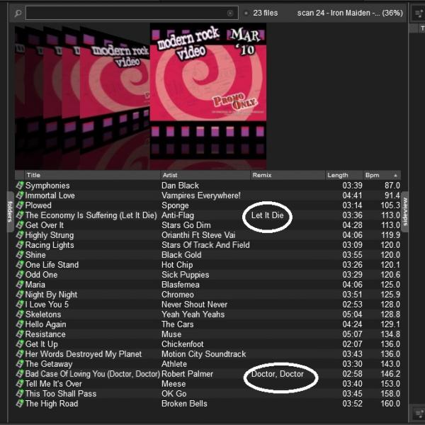

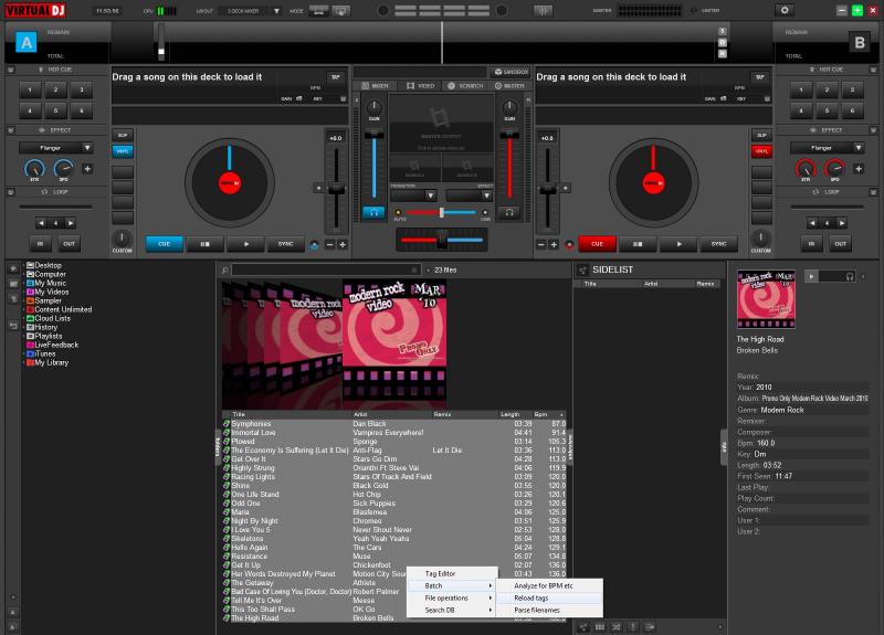

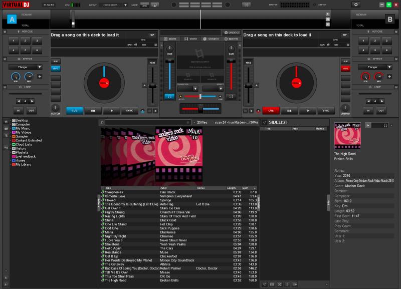

first picture is before i reloaded tags 2nd picture is clicking reload tags and the 3rd picture is showing no tag for the remix field which it was before i reloaded

Can you post a screenshot of the Tag Editor for one of the files that had a remix filled before?
Posted Tue 03 Feb 15 @ 6:11 am
shows you in first picture
Posted Tue 03 Feb 15 @ 6:16 am

this is set to yes

As you can see, the file itself contains a Title and Artist field, but not a Remix field.
getRemixFromFilename only works when there is no title or artist in the tag either, so it seems the behavior of reload tags is correct.
I suppose the Remix field was manually added before then in the database?
Edit: So probably the first time you loaded these files, title and artist field were not present, and the remix field was read from the file name.
Then when you modified the tag outside of vdj, it has written the title and artist tag, but not the remix tag.
