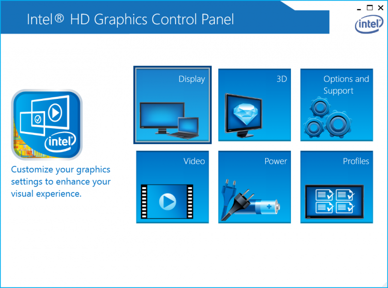

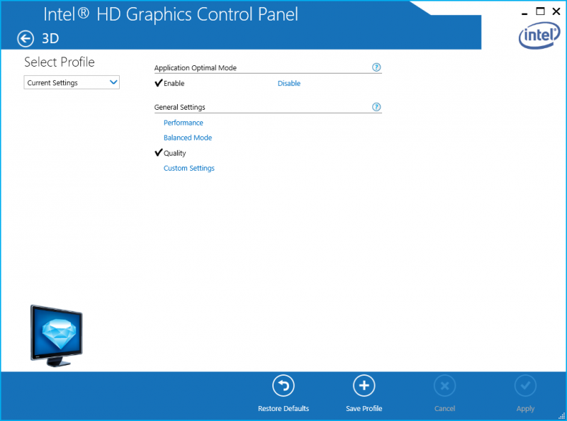

ok i'm home now and can see the machine
goto control panel
find "Intel HD graphics" open that then have a look at the screens below
i wold adjust the settings on the 3D area until its working better
good luck
