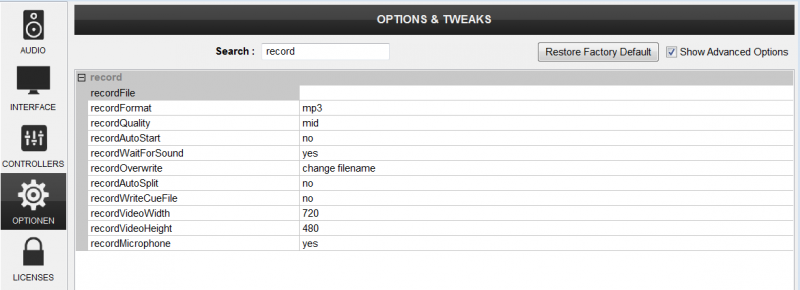

https://virtualdj.com/image/thumb/78958/154847/Untitled.png
other than playing around with the video height and width, which i have, i dont know what to do

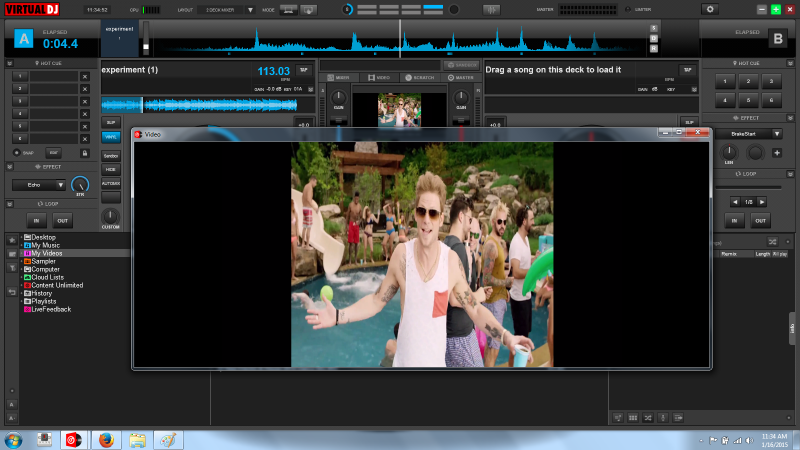

and this is an example of the size difference that I'm talking about...

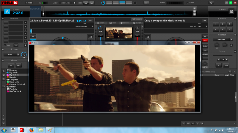

compared to this

If you're playing HD videos and want a recording of the same resolution, you need to record at 1920x1080 - not 1600x900.
Also, if you play a 4:3 format video then you will get black areas either side or a stretched video when outputting HD widescreen.
Posted Fri 16 Jan 15 @ 11:04 am

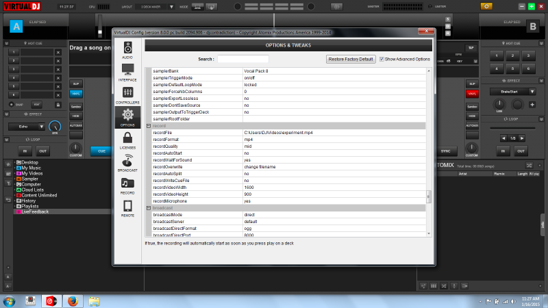

the 1920x1080 didnt change anything....
but if im in 4:3 ratio....how do i change that then..
because that might change something...because i still have the margins whether i change the height and width....it just spreads out the video and still keeps the black bars on the sides (margins)

See the letterboxing option in your config.

ok ...problem is solved....i had to make the settings 720X400....why?....because at 480 height it was zoomed in and cutting things out ...so this is as close as i can get it without it recording in HD...because i agree with you...my computer probably cant handle it.....and ROBROY ...u might wanna check if its cutting things off for your videos as well...a video with a logo on top or bottom is your best point of reference...
