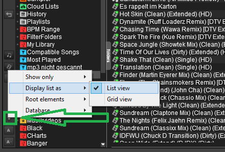

Click on this little button and choose list view:
