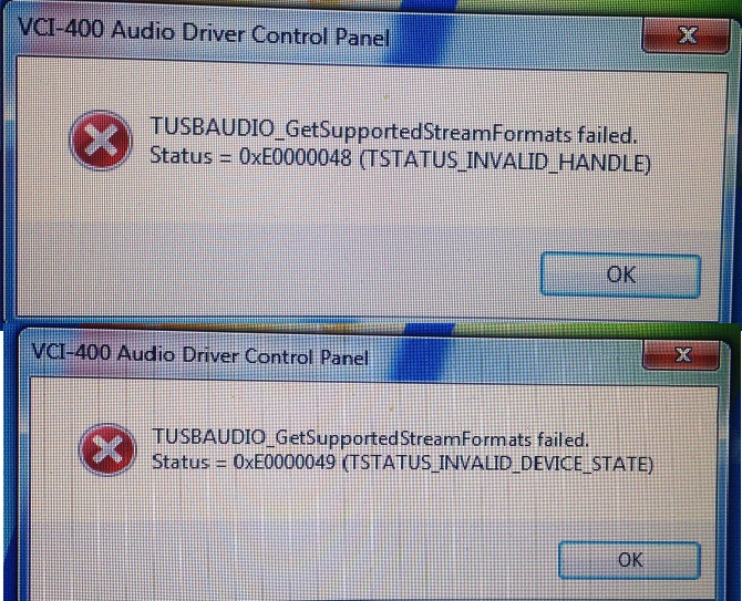

So I'm 2.5 hours into a show tonight and suddenly the music stopped . I had no midi control but I was able to start the song by using the mouse. The audio part of the controller still worked just lost midi. Any thoughts ???
I switched to MP3 then restarted vdj and it's working for now.

I've had this happen as well and you will likely be asked for more info. Win or Mac, specs & age, wifi on or off, doing videos or mp3, what type of midi controller & current drivers, anti virus on or off, auto updates disabled, was there a loss or spike in power to your system, so many variables.
Could be any of the above including a faulty USB cable.
You have to by process of elimination determine this on your own so you can gig worry free. Nothing worse than the music stopping with people on the floor looking at you like WTF.
One thing I invested in after this happened to me was a battery back-up and new USB cables.

What's strange is that nothing has been changed on the computer, I Have no anti virus , Internet is enabled, I was playing. MP3 not video. I did use netsearch last night a few times... ( it was running slow come to think of it). Pretty much the same configuration I've been using since V8 was released last May. I was on the 2094 beta build but I ran that New Years eve without issue. I Already picked up new usb cords. That was my first thought as well. I would think of the usb cable was bad I would have lost audio, I'll know soon enough
