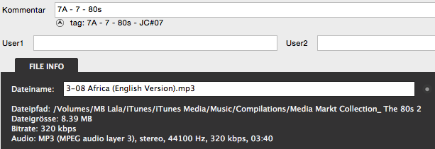

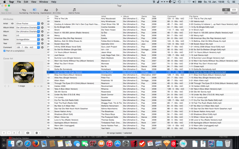

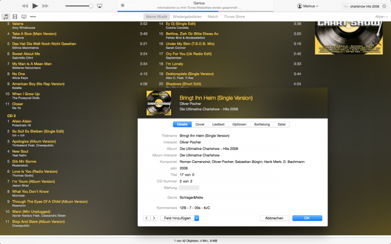

Yes, tried with 2126 (Mac) and again:
...as you see in tag and Itunes: same comment, but in VDJ...#*+!
DB was cleaned, tried everything (batch reload, add to db + reload...comments don't come over?!?). This is a big problem and very important for me. I got no idea, how to work around....

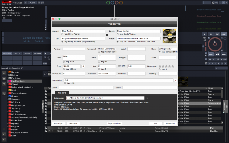

Take a lok at this:
ImO VDJ should take the comments (not the entry of another program).

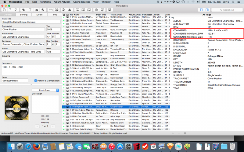

To be honest I have no idea either why Haui's method would work.
When using Reload tag, it doesn't matter if the comment tag was filled in already or not, it will use the one from the tag anyway (when getCommentFromTags is enabled)
The problem shown in the more recent screenshots also seems to be a completely different problem from the problem in the opening post.
(The original problem was that 'Reload tags' would not update the comment field, and this was a bug that had been fixed somewhere around build 2080 I think)
The problem in the more recent posts is different (as can be seen by the screenshot of the File Info, both the comment that vdj read from the file and the one currently in the database are the same, so there is nothing for reload to change)
The problem is, as shown by the last screenshot, that the file has multiple comment fields, in which case there is no 'correct' answer for which one vdj should take.
One explanation for why Haui's method may work is when setTagsAuto is enabled. In this case pressing OK after deleting the comment tag would also update the tag, possibly deleting the unwanted comment tag. A reload after this would then possibly load one of the remaining comment tags, which may be the right one.
Keep in mind that if setTagsAuto is indeed enabled, it may be risky to remove the comment field of multiple files at once, since if one only has one comment field it would actually delete the good one from the file.
Posted Mon 19 Jan 15 @ 8:56 am
