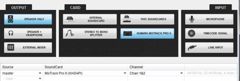

Update: now it is detected (uninstalled and installed again in device manager), but even though I put the mappers on the right folders, I don't see it on the Controllers tab. This is what the Audio tab shows:
