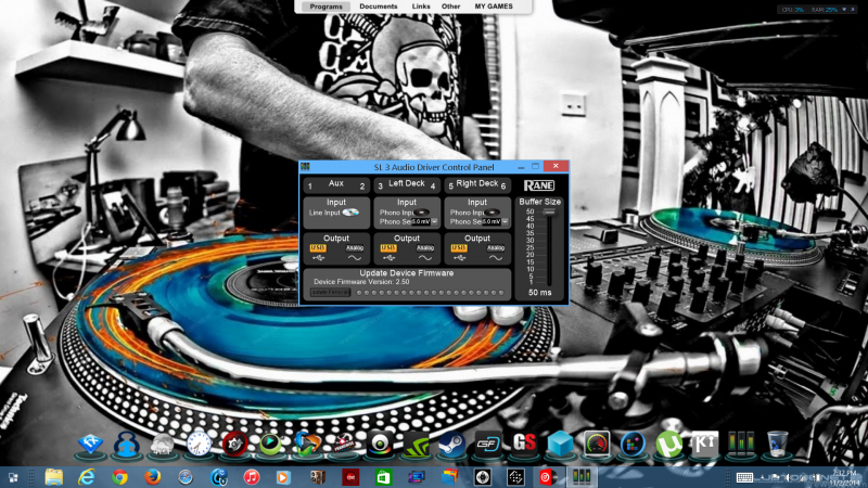

with this new update it was not like this before the last 2 updateI think i found the problem with timecode vinyl and the serato sl3 rane box in virtual dj 8 not reading the SL3 AUDIO DRIVER CONTROL PANEL I put the buffering size 0 threw 50 and it does not change anything at all the way the scratch sound it like it does nothing in virtual dj 8 at all so i think that why the scratching is stuff right now not crips like before.DEV that has to be the problem help.thanks

That's the buffer size, it shouldn't change the sound, just the latency.
It's also a driver level thing, so outside of VDJ.

It was working before the last 2 update so now when I change the latency it stay on 1 level even if I put the buffering size to 50 it should be a delay when scratching .but it does not so that why I think I am getting so air when scratching slow and the scratch are not crips like before.can not change the latency level. And I try timecode silence on 0.200 and 0.100 and 0.00 and still some air when scratching slow or rewinding it back to scratch.and pitch quality on 1 and 2 same thing..something wrong with timecode vinyl.

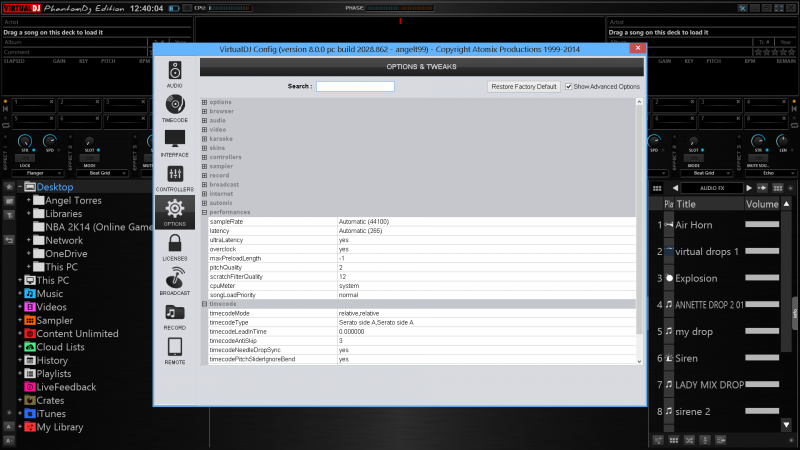

To all of you guys having pitch fluctuation issues, if you get some time go to the previous Build 1973 and try this:
go to options - timecodes - and change the timecodepitchsensitivity to 0.
After you see your pitch fluctuations go away, let the developers know we need this feature put back into the next build.

This was fixed in the past - the last build I think I tested was around #1973. The color of dvs has nothing to do with it.
I just noticed the timecodeSilence opition - in the settings - I will try lower/raise the values here - hopefully this takes care of the jumping issues..

Friendly Bump to have the "timecodepitchsensitivity" option put back in one of the updates.
After I test the latest builds when updated, I have to go back to using build 1973.811 because that is the last build that my pitch is steady with my DVS.
