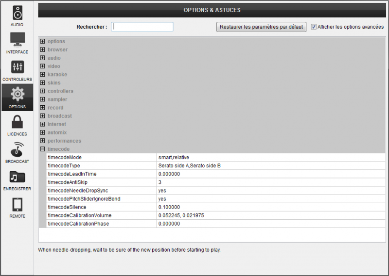

hello
At home timecode no longer works since 1960, I have no signal.
I test the signal V7 ok, I pass on the 2003/2013 V8 I have nothing, no signal, I spend on my other partition 64 bit windows 7 with 1960 timecode nickel.
my config:
64-bit windows 7
Maya 44 USB sound card
CVO vinyls serato 2.0 and 2.5 with S-120 cell Ortofon
Here is a screen shot of the settings in vdj:
my config:
64-bit windows 7
Posted Sun 19 Oct 14 @ 10:16 am

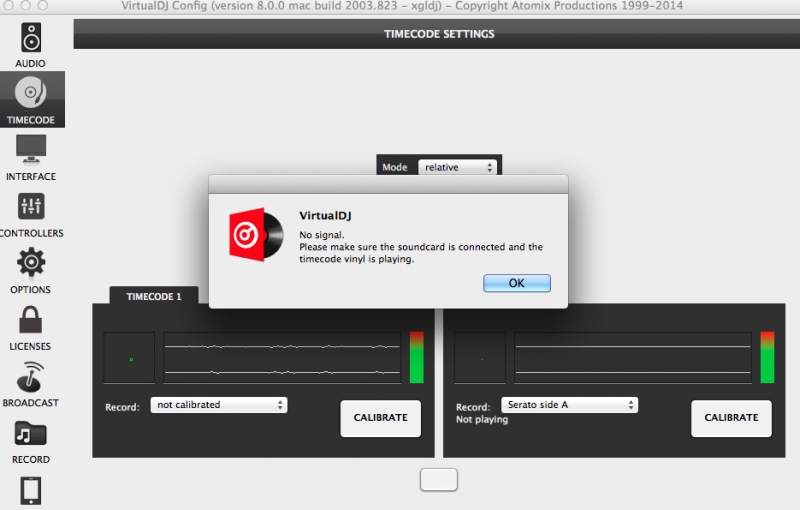

dj lylian wrote :
hello
Here's the answer, given in another forum:
(but it should belong here so I'm posting it again here)
xgl_dj wrote :
At least you guys can get it working - it this new version does not work for me..
As you can see in the graphic, your signal is way too low, it's going to be hard to get any decent quality out of it.
Go in MacOS audio settings and make sure the recording volume of your soundcard is turned up.
Or if you're using a Serato interface, make sure the level is at something decent, not -10dB.
The reason why it worked before and doesnt work now, is because we changed our philosophy about this.
Before, we were trying to get timecode to work no matter how bad the signal you'd feed us (even if it resulted in drifts because of a bad signal).
But we came to understand that many customers were indeed keeping a very bad signal and playing with it (and having sub-optimal quality, drifts, etc, because of it), while the signal would have been easy to fix in the first place (like in your example, where it's just your volume which is way too low).
So we decided that now, virtualdj will just refuse to play a very bad signal, instead of playing it badly, pushing people to fix their signal in the first place, and in the end improving the quality of scratch and getting a much better experience.
PS: like always in vdj, there are "ways". If you really cannot raise your signal volume for any reasons, and want it to play at low level, and you understand that you'll get a bad quality, drifts, etc, then you can manually edit the "timecodeCalibrationVolume" in the advanced options, and put something low, like "0.05, 0.05".
Posted Sun 19 Oct 14 @ 5:01 pm

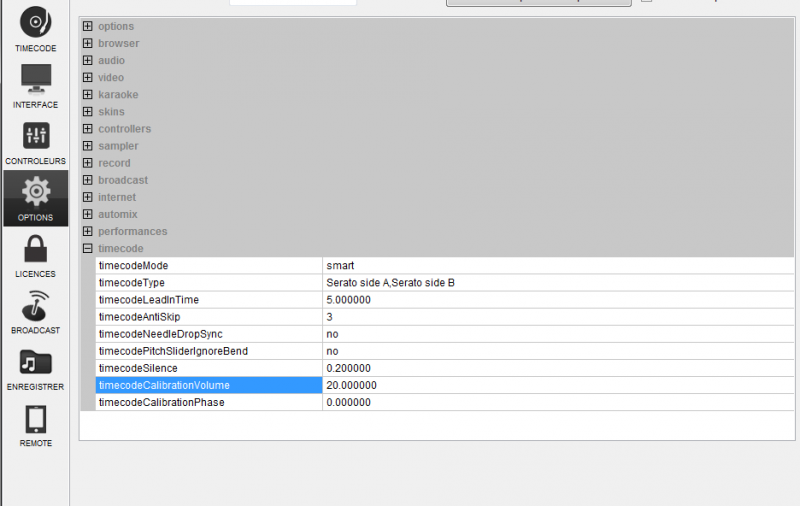

To sclavel:
First, I would like to say great work and thank you for the improvements in this latest build.
But, In the last thread of the previous Timecode forum, I mentioned that I had problems with pitch fluctuations (like others in these forums) and solved it by going to options - timecodes and changing timecodepitchsensitivity to 0
Is there a way to access the timecodepitchsensitivity with this new build?
Posted Sun 19 Oct 14 @ 6:49 pm
+1
Thank you jadacharmer for addressing this. This is the final issue I have with VDJ 8 and TCV. As dasouth2004 said in an earlier post "Still having pitch fluctuations of 0.7 while I don't touch the record & my strobe on my 1200 stays nicely at +-0%".
VDJ 7 did a solid job handling the "Wow and Flutter" effect with my TCV setup. A track would play at a steady BPM throughout the entire song without any variances. In VDJ 8 to blend or beat mix songs I have to constantly nudge one of the tracks to keep it synced properly. Not a big deal but makes for an unnecessary step when you want to apply samples, audio and video effects at the same time. Any suggestions on how to possibly get rid of the "Wow and Flutter" effect in VDJ 8 (latest build 2013.833). I think that's what changing timecodepitchsensitivity to 0 did. Although I've tried numerous settings, here's my current.....
Posted Mon 20 Oct 14 @ 9:23 am

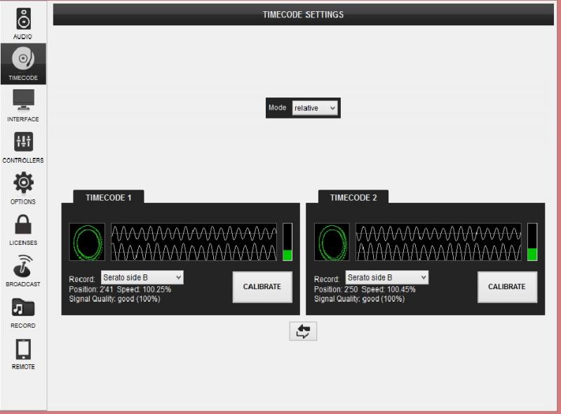

@ Mackey..
The pitch fluctuations make it impossible for me to mix..
The 0.7 is just on 1 deck so on avg, my total pitch jumps between 1.4 as I have 2 decks
Not knowing what it's going to do makes nudging useless.
Was planning on buying new timecodes this week, still in doubt wich ones to get, but I'm 100% sure it won't fix my issue.
SO devs.. wich timecodes should I get.. I can still get the Virtual Vinyl ones with blue/red label or serato & other standard ones like mixx & traktor
Posted Mon 20 Oct 14 @ 10:15 am

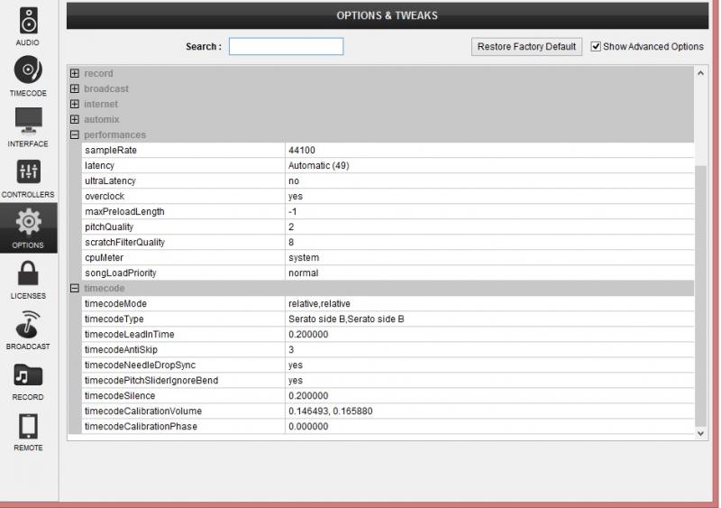

To the DEV Team
something is wrong with timecode vinyl The pitch fluctuations make it impossible for me to mix and i just tested it with serato and in serato it is fine to mix no pitch fluctuations at all the track stay sync together when mixing and having the pitch on the turntables match the other pitch slider.
Posted Mon 20 Oct 14 @ 4:43 pm
ok did some testing with timecode vinyl there is a problem when u put pitchquality to 1 then u get pitch fluctuations and when i put pitchquality on 2 its no fluctuations in the pitch and it is eazy to mix in a track so that not good for scratch dj like me we need pitchquality on 1 so we can get a good scratch.DEV WE NEED YA HELP THANKS.
Posted Mon 20 Oct 14 @ 6:11 pm
