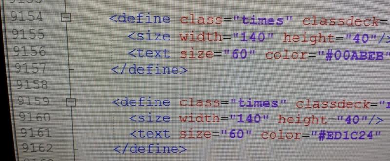

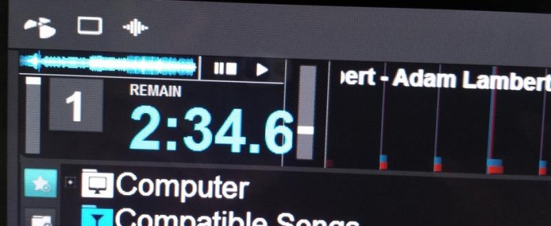

hello Fruit....see if you can help me out. i opened up the XML and on lines 9154 & 9159 i chagned the size of the tyme Remain/Elapsed on both decks so i can see it better. but now as you can see in the pictures the blue numbering (left deck) the 6 is starting to cross over the lines. i want the 2 closer to the left. but in line 9154 in the xml there is no <pos X= / y= to move it over ? same thing i want to do with the right deck (red lettering) i went and made the Width bigger but the numbers still overlap the lines. can you direct me to what lines in the xml have the position so i can move the some thanx
ohhh yeah forgot to mention i only use full screen browser mode just in case you give me the line #'s fo the other browser mode ..jpg)
.jpg)
.jpg)
.jpg)
.jpg)
Posted Sun 03 Apr 16 @ 7:22 pm
Ok,
I'm assuming you're using the version 0.57 / 0.6 of the skin.
In the panel define "times_L"
- line 3326
- line 3427
- line 3438
- line 3449
In the panel define "times_R"
- line 3534
- line 3635
- line 3646
- line 3657
The waveview window is shared by all layouts so the mods you'll do here should show in every of them.
Also, if I may advice... You could wait to do this in the version 0.7 because I believe you'll be happy. The extended browser and jukebox layouts have been entirely reworked from scratch, with now for instance some kinda pads that can show up, allowing you to roll, slice, sample or cue from those layouts, and many many many other improvements.
0.7 will be released within this one week to come, if no bugs found. Maybe tomorrow or so...
Cheers !

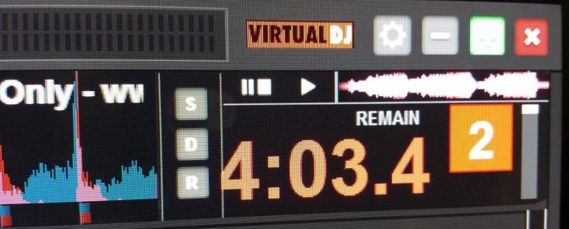

Interesting skins however please check this out.
1. right click on stop pause button does not remove song from deck.
2. most importantly for me this is how my wave looks after this new 0.7
I am hoping to have this same half wave with same CBG but in neutral color waves. Am I missing some settings?

Confirmed Right click on stop button doesn't unload deck.
About the second one, play with the wave options on the right.
