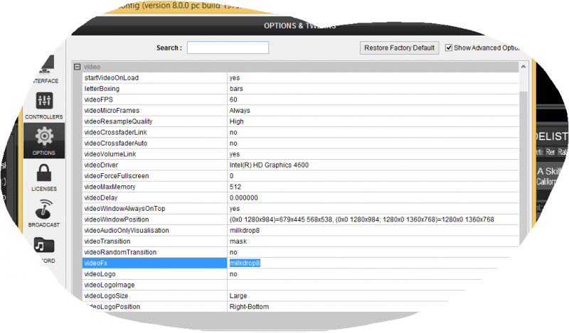

if you have Milkdrop8 as your mp3Visual, and you have a video playing, then load continuously a couple of other videos on the next deck, eventually after a couple of vids Milkdrop8 will take over the video on that deck AND the master video out. the only way to stop it is to restart v8
removing milkdrop8 from the mp3visual setting cures this and I cannot recreate with other visual plugins..

IF I keep milkdrop selected for mp3visuals but remove from 'VideoFX' I don't seem to have the issue :(

also, after some further testing, IF I don't have milkdrop in 'VideoFX' then the issue doesn't occur..

If I follow your steps, Scot, I get milkdrop cut in within about 5 videos.
An observation is that this seems to happen when milkdrop is in VideoFX field..
If I remove milkdrop from there, I don't get the problem but it would still work as intended for MP3's.

No reason to have it selected as the current video effect anyway IMHO if it's active as the visualisation. That's all that field is - the storage for the current 'selected video effect' on the skin.
