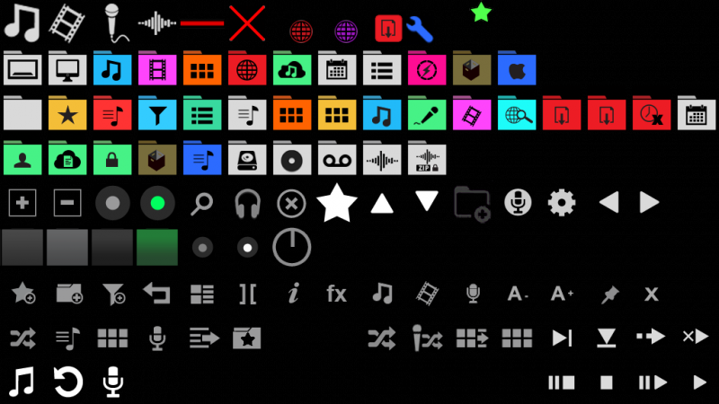

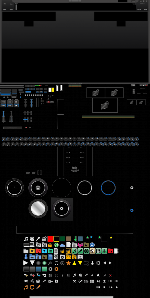

1st you need to download http://www.photofiltre-studio.com/pf7-en.htm then use it to open your favorite skins & change that dumb little red line to what ever you like. im not a skinner but once i messed around with it. its super easy. (note some skins wont let you change them)
Posted Fri 14 Nov 14 @ 3:22 am
in my skin i changed. look for the top roll of icons & change the (5th) icon from the left. like some skins i made it an bright red square, bright green square. really what ever you want it to look like.
Just change the 5th icon top row from the left
