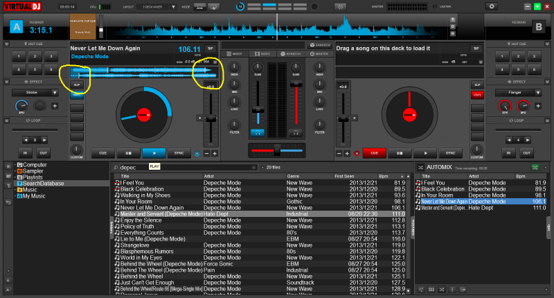

I'm not sure why this happens, it's not all the time but more often then not. When the songs are queued up in Automix mode, at the point where the songs mix in, instead of getting a 8 sec lead-in, it just ends the song and goes to the next. (see screen shot). If I switch to some other option, then things fade-out/fade-in correctly... It's just the SMART option that seems to not work correctly. It's almost like when it analysis the song, it can't find something so it just dies... Any ideas on how to correct this so SMART works correctly??

Ok... I brought the xml file from my other computer and installed it on my main machine. For a while, things looked good then suddenly, I started getting the issue of where the song just cuts off (see picture)... as you see, towards the end of the first song and the begging of the next, you see this bar... this causes the song 1 to stop and song 2 to start abruptly.
Maybe someone can help with this.
I will continue to poke around to see why SMART mix works some time and not for others. I can't find a way to duplicate it all the time.... this is very frustrating.

So after some playing around it seems that the issue might be song related. If a song is "broke" then the song prior breaks and then when that broke song is playing, the one after it breaks. If I remove the "broke" song from the 3, then song 1 and 3 play fine. So, what can it be that a song breaks SMARTMIX? All of my songs are .mp3 with song 1 being 128 sample rate and song 3 being 192... I just can't figure out this mystery...

I bit more of information.... When these 'broke' songs play, I will notice that when I select the AUTOMIX type it will say "SMART (cut)" while the other that work say "SMART (tempo)". so, what is it that makes AUTOMIX choose cut or tempo?? Something is driving this setting??
