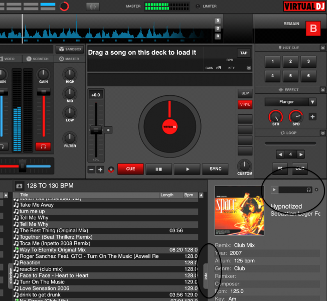

          i think he has preview player activated
You'll find the preview player at the top of the info panel (standard skin)

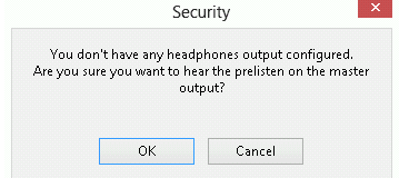

          What are your settings for the prelisten output?
And did you ever get this message?
       Posted Tue 16 Sep 14 @ 3:50 am
Yes I have seen that message, but I think the confusion here is, for me anyway, is that it just changed on it's own. And we didn't understand that. Both of my decks were idle, but there's music playing because I inadvertently clicked on a song in the browser(??). Never happened before. Then I'm searching all over the place trying to find where the music is coming from. At this moment, I do not have my headphones configured, and it does not do it. Plus, regardless of any settings I change, I cannot recreate the auto playing of a song in the browser when clicked on. Like I said, Gremlins!!:-)

          I reckon it's not helping very much that the preview player is now tucked away behind the info tab rather than being on display at the bottom of the browser where people can see it.
People are not realising what's going on because they can't see the player unless they happen to have the info tab open.
