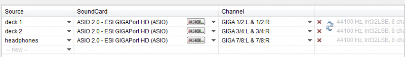

I cannot figure out how to get this sound card configured. I have tried multiple cables and multiple usb ports. I've tried both with a power hub (also connecting a DAC 3) not on the hub, and with no other devices plugged into the computer. Here is what I currently see and hear:
Deck 1 2-Gigaport HD + (WASAPI) Channels 1&2
Deck 2 2-Gigaport HD + (WASAPI) Channels 3&4
Deck 3 2- Ggaport HD + (WASAPI) Channels 5&6
Everything just plays through channels 1&2. I have tried different combinations and even delete V 7.X thinking that might have created a conflict.
Not sure where to go from here. Suggestions?

First you need to download the drivers from esi for your gigaport. It is an asio device. Decide which USB port you want to use because you will always have to plug it Into the same port everytime. Once you install the drivers you can set it up without issues

Note: I reloaded drivers, I now see and tried Gigaport HD Audio Driver, tried that. Same result.

Getting closer. When I use ASIO, deck1 and headphones work correctly, deck 2 plays through channels 3 & 4 AND 7 & 8.

The behavior is that deck 2 also plays on the channels assigned to headphones. So if headphones are assigned to 5/6, deck 2 plays on 3/4 and 5/6. If I assigned headphones to 7/8, deck 2 plays 3/4 and 7/8.

Got, changed headphones to preview. All is good. Thanks for the help.
