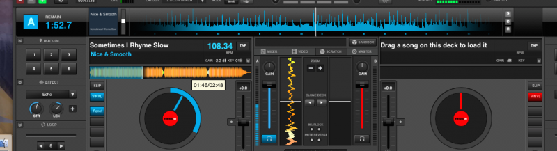

Ok , I understand know, you want the rhythm zoom and the scratch zoom to be different speeds. You can do this..
Here's and example of the waveforms at different speeds:

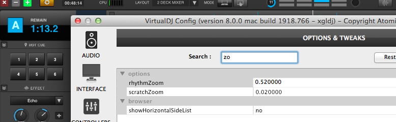

To adjust the speeds , to the options:
And manually adjust scratchZoom and rhythmZoom to your liking.
When you adjust the zoom, both values get adjusted together, but you can adjust manually to have them running at different speeds.
I forget vdj can display the waveform in the rhythm view or in the mixer area or in a few other areas depending on the skin.
