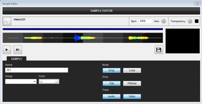

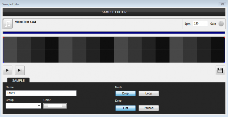

Here's the problem...
Working ok before update
After update
I realise this could just be a coincidence and could be connected to the settings I mucked about with previously, be grateful if someone could confirm it is a bug or more than likely I have adjusted a setting and give me correct settings to get everything back to normal, as up until now I haven't been able to see anything in config that will get this working again.
After update

Reopened vdj, went to test video sample editor and audio/video tab were missing as was small video window as in the above image.
Has any one got guidelines or remedy for this.
