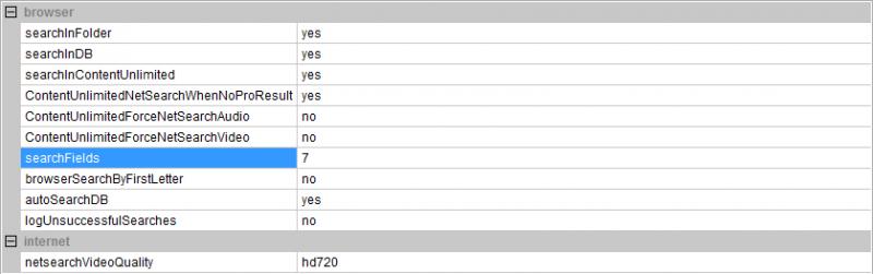

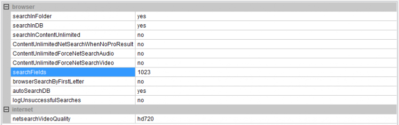

Check 'advanced options', serach for the term 'search' and please provide this :

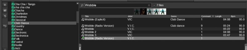

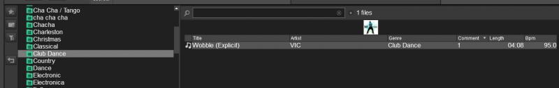

Here's two screen shots of the issue I'm having. I tagged the Wobble (explicit) Club Dance and Wobble (Radio) Club dance. (Note that the D is in caps on one and not the other) The first image shows a search of the Wobble and they both show up with the different tags (Genre). But on the left under Genre you see only one genre for Club Dance. The second image shows that when I select the Genre Club Dance, I only see one Wobble (Explicit) which is tagged Club Dance and the Wobble (Radio) with the tag Club dance is not in the list. There is no Genre for Club dance so the Wobble (Radio) is now hidden from all Genres and the only way I can locate it is by searching for it by name.
