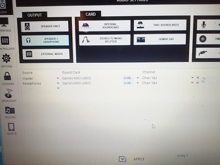

Why cant i get my g4v to operate correctly with vdj 8 pro? Cant get the decks2/4 to play sound out, theyre playing just no sound ! Problems with headphones too ! This all works perfectly on vdj le and vdj 7 pro so im totally lost ! Anyone know all settings ?
Posted Sat 15 Aug 15 @ 4:35 am
What's your sound setup ? Can you post a screeshot of config window ?
Posted Mon 17 Aug 15 @ 11:15 am

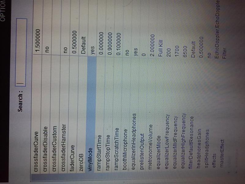

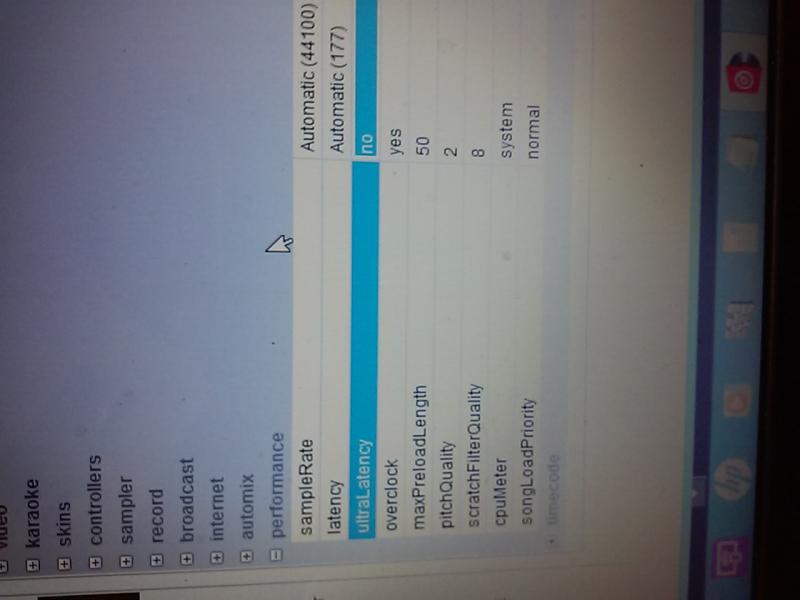

When I get a chance I will take a screenshot of my gemini g4v setup. I dont mind. Just give me time to post. I work M-F hahahaha.
Posted Tue 29 Sep 15 @ 7:26 pm
Here you guys go....here is my setup
Posted Tue 20 Oct 15 @ 8:12 pm
