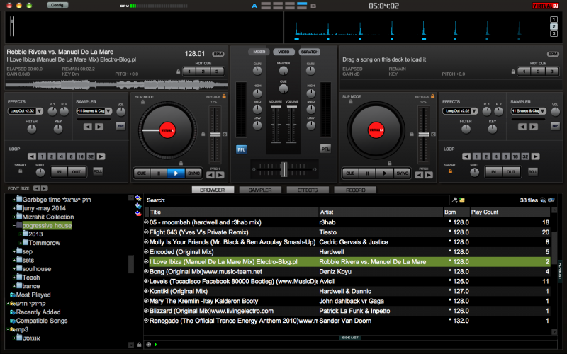

i just notice that the vdj8 doesn't sync well songs
the red/blue little cube need to be more closed to the attack pick i need all the time to fix the beatmix and to( + & - the band pitch) to correct the mix .
in the vdj7.4 for example i was not need to fix with the band pitch the mix .
this is the result take a look
vdj 8
vdj 7
what to you thinks?
vdj 8
vdj 7
what to you thinks?

In V7 the marker for the downbeat was positioned from the centre in V8 the marker is positioned to the left edge.
Ah, but in his pic the CBG blob is not to the left or in the centre. It's to the right. :-)

Left edge of the marker, hence to the right of the peak

looks like the grid on your track needs to be fine tuned .... i Have to adjust almost every track and i must say get used to it cause some of my tracks i have to do more then once to get it to stick and some never do :-)

I think it's another algorithm system.
I must to say that many song that synchronize well on the 7.4 vdj . Not sitting together well in the vdj8 . All the time you need to band pitch + or - . The cubes in sync mode look perfect together on the mix, But you got off beat mix , as you see in the pics above the cube position are different. Vdj8 vs vdj7.
Do you thinks that Maybe the team development may fix this problem? Or its stay like this.?
Someone have the same problem? !
