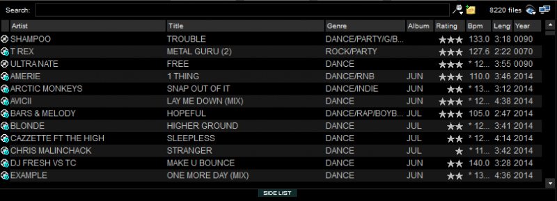

V7 when booting up
V8 booting up

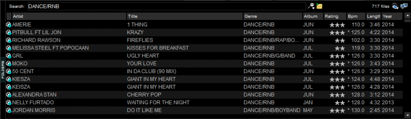

v7 search dance/rnb

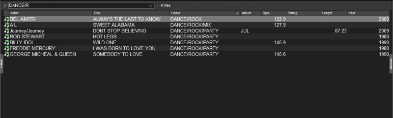

v8 search dance/rnb can't even put in full search words because once i put in the n in rnb the search area shows zero results.

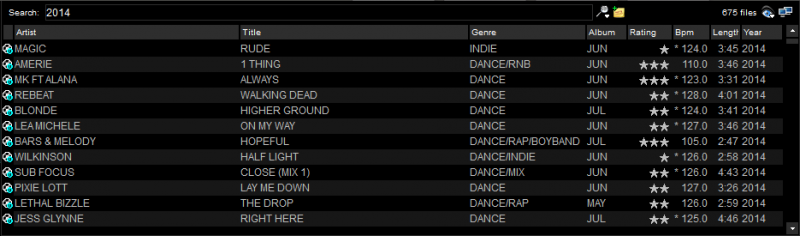

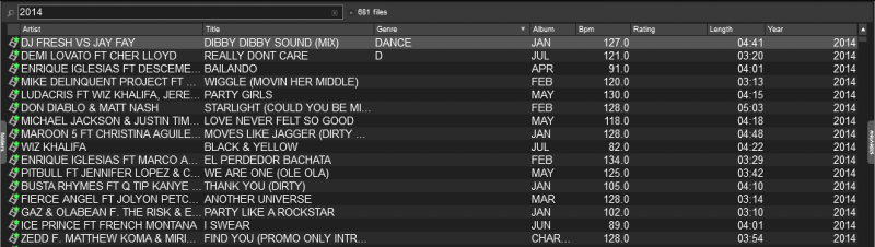

v7 year search
v8 year search
I can give you more examples of this problem if needed, it's just got me completely baffled, even in v8 I'm selecting the field for it to search in and it is still failing on search results.

After looking at your shots, I have a question.
It seems the two softwares don't bring the same infos so could it be that :

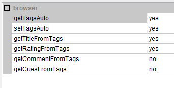

- v7 would read infos from the database
- BUT v8 would read it from the tags (this is avoidable)
If that makes sense ?

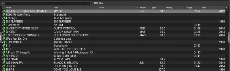

Also, why the missing information in the genre field in v8, anyway to correct that.
Search config/options for 'tags'.
There's a bunch of yes/no options for reading and writing tags - but there's nothing specific for genre for example.
In your pics it shows more genre info in 7, but where is the genre info stored? Is it in your actual files or just the database?
Your 7 v 8 pics also show different tracks on screen, so it's difficult to compare. Can you sort the files the same in each s/w?

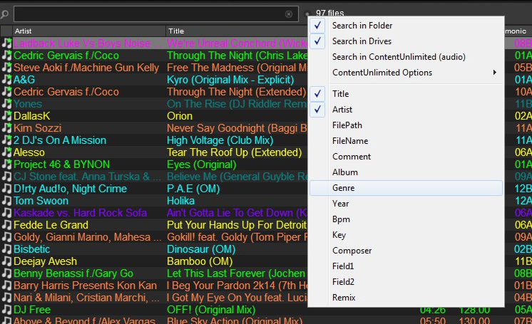

What options do you have selected for 'fields to search' (via the search options dot between the search box and the file count)?
I just did a test by naming the genre of a file DANCE/RNB like you, then typing that in.
Initially it didn't come up in results, because by default not many fields are ticked to enable searches.
Possible... default search fields are artist, title and filepath only.

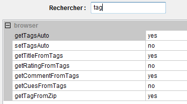

I meant those options :

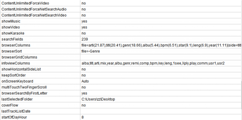

Here's my settings... they were exactly as above but changed to these after your initial post and same results.
You should be getting the same results as v7 if all the data copied over properly, the case is from my experience it doesn't...I've had issue too with missing information that should have transferred, but didn't, but maybe they have addressed this by now?
Try this on your desktop machine providing you have v7 also installed, rename your v8 database and then start v8 it should copy over from v7 database and try and see in v8 if the missing data has transferred.

And what about turning "GetTagsAuto" to off (and maybe close/reopen VDJ) ?
Tried it, even rebooted... no luck.

have u adjust search settings to include the fields you want to search genera is not a default see image this is default settings
Yep, already done on initial set up, but thanks for the suggestion anyway.
Okay, if you had the "Get from tags Auto" On then you will have to turn this setting off fist in v8, then do what I explained to you so this should read from your v7 database Only and write those fields into v8 database, Not your tags, then it should work... After all it does work in v7 right?
