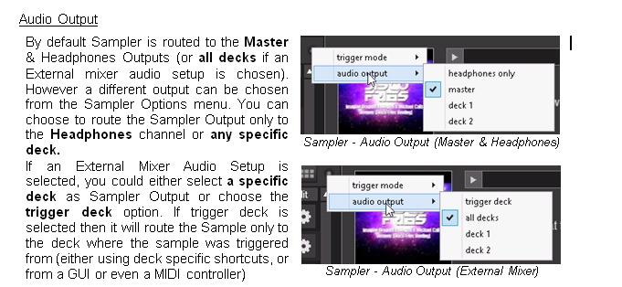

Did you already play with that options?
Posted Wed 23 Jul 14 @ 3:18 am
Thanks bro!! That did the trick but instead of having the sampler share deck 3 I just run a cable with 1/8 jack on one end and rca's on the other from my laptops headphone jack to channel 4 on my mixer. So now I have 3 track decks and the sampler all on theyre own channel.
