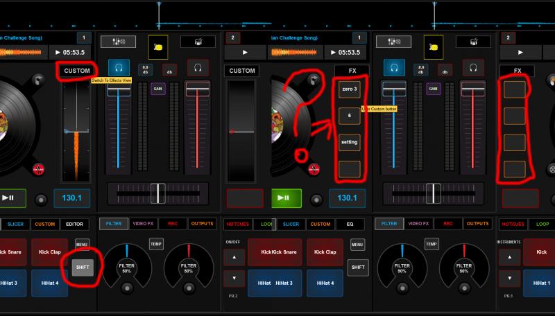

Noticed this...
When i hold shift down and press the FX, wich now is calld Custom, a set of user custom buttons shows.
But what is with the ZERO 3, 6 & Setting on one deck, an nothing on the other, what do they do , and how can i change it ?
Update!
Found out it was my old custom settings from other skin, but still couldn't change it with out going back to other skin first and change it there
Update!

Changelog :
SHIFT+Custom Buttons opens Button Editor
Reminder : SHIFT+FX button shows Custom buttons instead of vertical ScratchWave
Posted Sun 11 Dec 16 @ 1:01 pm
in this skin, [shift] and right clicking on [custom] to show the 8 custom buttons instead of pitch sliders..
on the right hand custom buttons, once I have set a custom button I cannot do a right click to edit that button. I can do this on the left hand side.

Custom buttons...
If I have set up some custom buttons like this :
1. setting 'zeroDB' 'default'
2. setting 'zeroDB' '-3dB'
3. setting 'zeroDB' '-6dB'
4. setting 'zeroDB' '-9dB'
Is it possible to have a colorcode so when its "not on" its lightgrey and "on" bright red ?
What code should i put in the color field ?

Something like..
setting 'zeroDB' '-3dB' ? color 'gray' : color 'red'
Replace gray/red with #html or r,g,b values to get the desired colors
Posted Thu 09 Feb 17 @ 2:58 am
setting 'zeroDB' '-3dB' ? color 'blue' : color 'red'
Does not work..
Tried changing db value for each button, all stil turns up red
Does not work..
