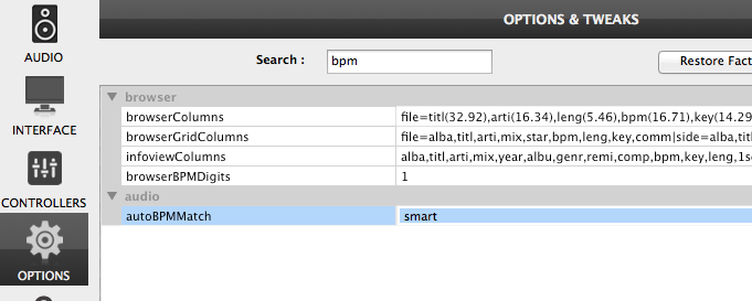

I have done something to my vdj8 last night at the venue I was at, under the pitch I can see a shadow of the pitch fader , what I have I done to turn this feature on, also when I put another song into the other player it is matching the bpm of the other the song in the other player ? How do turn this off

To turn off the pitch matching. In the options - select autoBPMMatch and set to "no"
