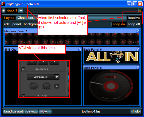

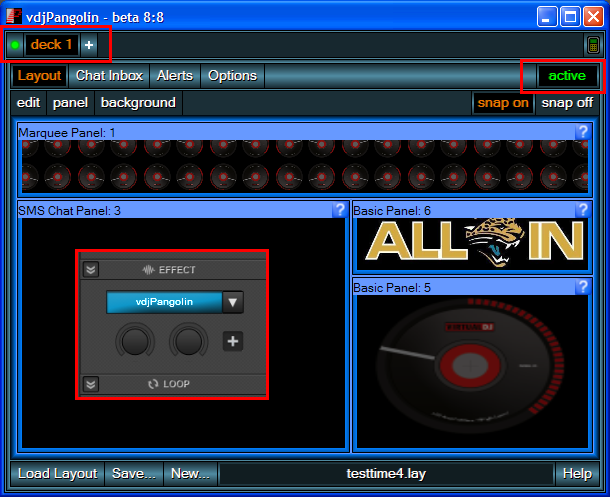

Hi Scott,
It is a little confusing to explain but let me try again with some screen shots. Using deck 1 for explanation but applies to any deck or master.
In this screen shot, EV has been selected on deck 1 as the effect. So EV brings up it's user interface. EV does not care about the [+/-] buttons and it brings up the UI regardless. Also, there is no [+/-] button for a master. The activation state and the plus minus state is synced in the VDJ interface and the EV interface.
This next image shows EV has been activated. [+/-] state is still at +
Everything is good up to this point. All works fine. You can activate / deactivate or change the [+/-] state from the EV user interface.
Now go to the VDJ interface for deck 1 and select some other effect. So now the FPS effect is selected on deck 1 and not EV. EV is still active. The EV [+/-] is still [+].
At this point SendCommand stops working for EV since it's not the selected effect. I cannot deactivate EV at this point from the EV user interface without the work around. Returns S_OK but does nothing.
VDJ thinks, well it has no UI [+/-] and it is at [+] so it's confused. If I go ahead and set [+/-] to [-] then it works but then causes other user problems. Looks like this was not planned for. The normal chain of events for a non-custom GUI plugin is to bring up the UI in the side panel or just reselect the effect to change it's state. It's confusing at best for user and I am trying to change that with the EV interface.
Does that help or do you need more info?

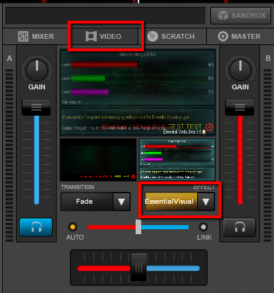

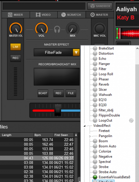

I don't proclaim to be an effects expert so if i'm wrong i will stand corrected.
But with the master deck - if you activate the EM from the VideoMixer panel:
It shows as ON also in the Master drop downlist - even though not selected:
So they are actually pulling the same information from the Pangolin GUI. They BOTH use the Master GUI regardless of where they are selected from, so you will only ever have one instance running on the Master deck.
The same is true on the decks also - you can fill all three slots with the same effect - but it is still only one instance and when you switch it off from the Pangolin GUI all three slots go off simultaneously.

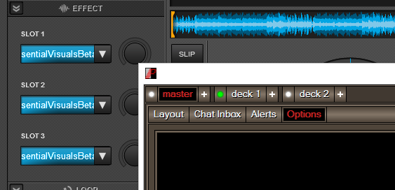

Well somewhat true. If you select EV in video and then select EV in master. I get called twice to load it up. Internal to EV I deal with and it looks like one, but there are 2 instances.
If I have EV as effect in video tab and not as effect in master tab and then do get master effect_name it will return the effect on the master deck as expected. But you can't address the video tab effect that way as far as I know.
In the case of 3 slots on deck 1, 3 instances of EV are loaded. As with master, I hook them internally in EV as one.
In the case where EV is loaded on multiple slots, it knows to only draw itself once even though it will be called multiple times to draw. It just doesn't make too much sense to draw it on the same deck like that more than once. You can try it with FPS effect and it will draw more than once and should be blurred with text overlap.
