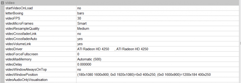

As I say... I use an IBM, and that part works perfectly for me. I know of nothing other than incorrect settings that could cause your problem. Here are my video settings, if you'd like to compare while waiting for the experts to weigh in:
Posted Mon 01 Jun 15 @ 9:08 pm
Have checked my settings and it is probably that videoForceFullscreen was set to 1 as required for a computer using dual video cards. I have changed it to 0 and it works as you describe. The Mac has dual video cards, a high performance one for using with mains power, and a low performance one for conserving battery power when not plugged into the mains. That's why mine was set to 1. This has worked fine as I have been a video DJ for over 8 years, first with VDJ7 then with VDJ8. I've moved into a different market doing weddings now and sadly don't use video anymore. All my tunes for the last 8 years are videos from Promo Only and I like to see them showing onscreen even though they are not output to external screens.

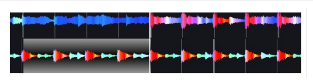

Hi,
I use Fruit Skin with the V2483 and V2587 , how can i get if its possible visual marks on the waveform like the picture :
