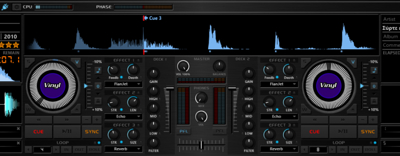

I'm not saying that the reason inverted ways are not present any more is due to the fact that you can move the needle mark ("earline" for Frut)
However, skinwise it's not that simple because in version 8 you can overlay any graphic you wish as your needle and that graphic does not need to be "centered" too!
Take a look on this snapshot:
The needle is placed on 1/3rd of the available rhythm width. Also it has an overlay on the "played" part (it's darker).
Graphicwise, this is a simple graphic overlay that's NOT centered on the needle position. If VirtualDj would programmatically try to "reverse" this then the needle would be presented wrong.
That case should be taken care of the skinner itself. In other words the skin creator should query the settings if the rhythm is reversed or not, and accordingly use different graphics.
Anyways, I don't wish to hijack Frut's topic any further and I believe you have made your point.
It's up to the devs now if they're going to bring back the reverse option or not.
So I believe we can all "calm down" now :)

I'm not sure this is a total highjack, as Fruit seemingly was interested in this aspect from a programming standpoint, as well.
Regardless, what I understand you to say, is pretty close to what I was speculating? If so, maybe Fruit and I can figure out how to simulate it?
Posted Wed 04 Mar 15 @ 7:43 pm
You can't reverse the direction at the moment, so no, you can't simulate it.
If you were able to reverse then the skinner could query the settings to see if the direction is reversed or not. But that's a big IF
Posted Thu 05 Mar 15 @ 6:18 am
