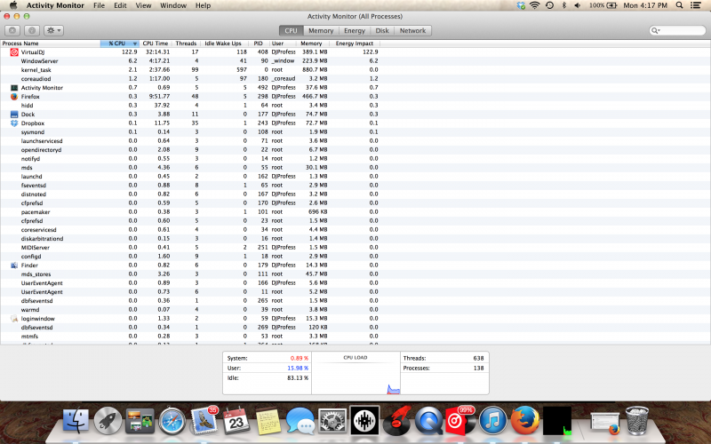

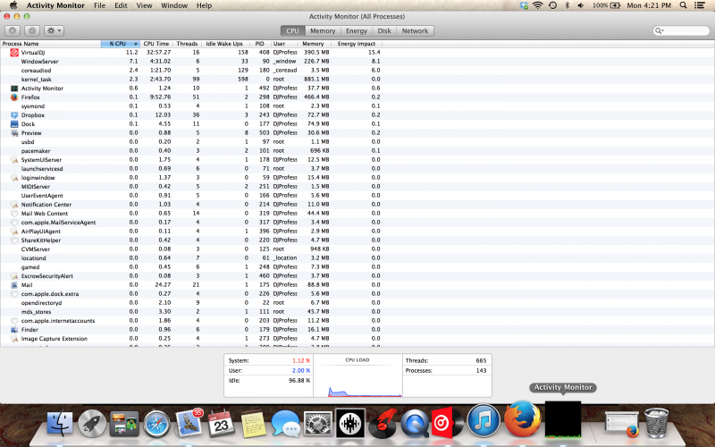

The latest build 1845.694 has a file that was formerly MaxSkinFps is now skinFPS. The build reset the value to 30. Before the build I had changed the setting to 20 which lowered my CPU usage.
I'm posting a picture with the 30 setting and with the quieted 20 setting.
I am planning to vist the Apple geeks to see if there is a way to tweak my processor to take advantage of my 4 core processor. These screen indicate either the software is missing something or an adjustment is needed on the Mac side.
Mac with skinFPS set to 30
Mac with skinFPS set to: 20
Posted Tue 24 Jun 14 @ 11:05 am

Nope, wasn't downloading anything or running any other processes in the background. The only thing running in the background is Wifi and I have a strong connection so doubt if that is it.
Here's what interesting, My 11inch Mac air is okay with the skinFPS at 30. The MBP with Retina, not so much. I'm right in the middle of my busiest season so haven't had time to head on over to the nearest Apple Store to see if the geeks there have any ideas on the Mac side.
