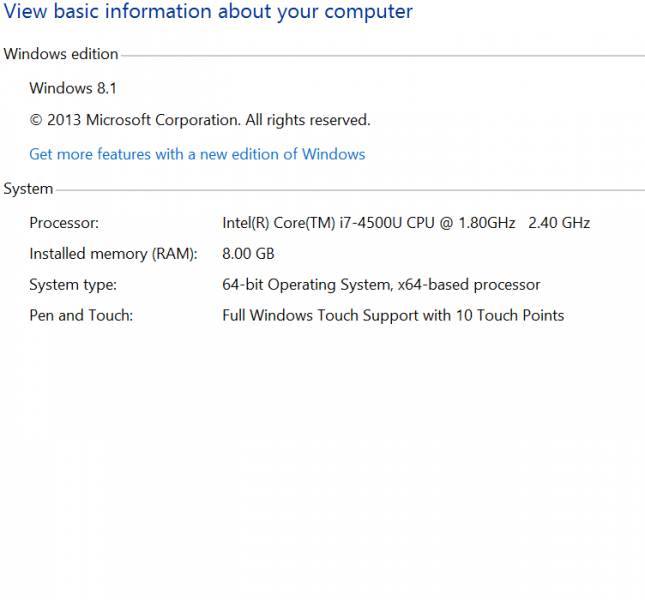

Hello Community,
So when using the NS7ii, if I have a deck playing and load another track on the other deck the deck that is playing will sometimes stop (while the other track is being analyzed) and once the track is analyzed the playing deck will do a 'backspin'. I noticed that this happens more when I load a track off of my HDD.
Specs:
•Intel Core i7-4500U ULT 1.8 GHz (4 MB Cache)
•8 GB DDR3 RAM
•256 GB Solid-State Drive
•Windows 8.1
External:
2TB USB 3.0
Any suggestions/help would be appreciated. I have tried changing the latency to no avail.
Thank You,
dee_jay_boy

          According to the Numark web site, your PC is below the minimum required spec for the NS7 II (2GHz w 32 bit OS / 2.4GHz w 64 bit).
    Posted Tue 10 Jun 14 @ 6:40 pm
          How can it be below? This is the one of the top of the line Thinkpad Yoga with the new Haswell processors.
Highly doubt that's the case.
I'm not a Serato user but will try this with Serato and if the same thing happens then maybe my computer isn't up to par (which again I highly doubt) if this doesn't happen while using Serato then the only thing I can say is causing the issue is VDJ.
Adding to this I owned the NS7 which worked like a charm on my current laptop running VirtualDJ 7 and these are their system requirement for the NS7:
64-bit Windows 7 Intel* processor - 2.4GHz Core 2 Duo 3MB L2 cache 4GB RAM
so... again I don't think is an issue about process power or system requirement.

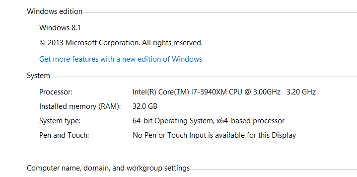

          I am experiencing the same problem. Just got my NS7ii because I was experiencing problems with another controller. Now this happens. So disappointed. Here is my computer spec - if it is not good enough then please direct me to which planet you got your laptop from.
       Posted Fri 22 Aug 14 @ 7:44 am
