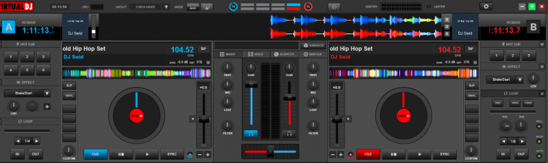

Not sure if it's a Mac thing only or not (since I'm on a Mac.) But almost every time I load a track and hit play (with syncing on) that the music is delayed from the actually view of the wave. To fix this issue I would have to play the track a few times before I get it ready to mix. I posted a picture to better describe what I'm saying. The grid looks like it's way off, but the sound that's coming out is actually synced perfectly. This doesn't happen in 7.4 and it only happens in 8.

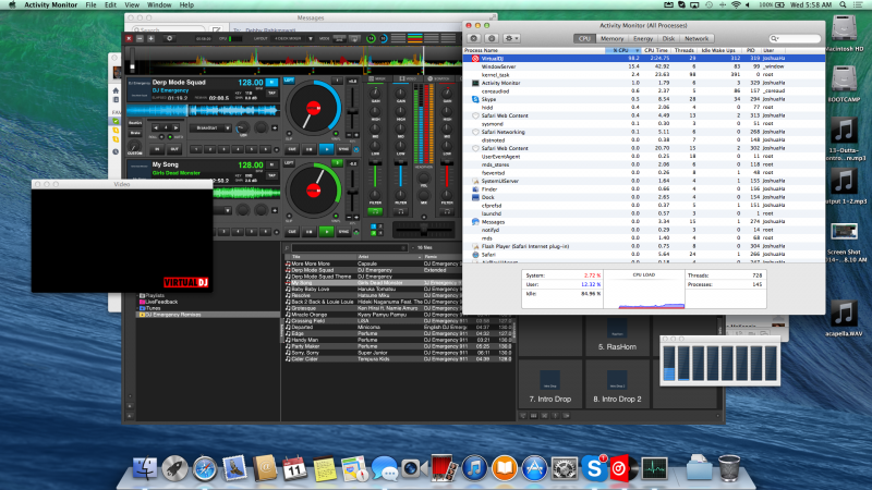

Thanks to Ed (from the FB group) for reminding me to check if all my cores are being utilized with VDJ8 and it looks like it's only using 1 core. I'm using the latest MacBook Pro. Could this be a bug with Haswell/Crystalwell processors?

Did you check what happens while loading a new song, or analyzing a song, and playing a video, perhaps at the same time?
Anyway, one more time, the topics here are about regression bugs. Bugs that are not in the public build, but are in the current beta. Things that would prevent this beta from being sent to the public, because it makes some things worse.

Ok sorry. These bugs have been present since the first build was released and I'm on the latest beta. Yes I did all that and it's only working with 1 core.

While looking at how VDJ 'feeds' on hardware, it appears that it has problems threading properly and likes to use only a single core of a processor for most operations.
^ This!
Anyway I hope my bug reports help a lot to get these issues resolved. It's not like I'm trying to bash the software. I'm just trying to help to make it as stable as possible.
