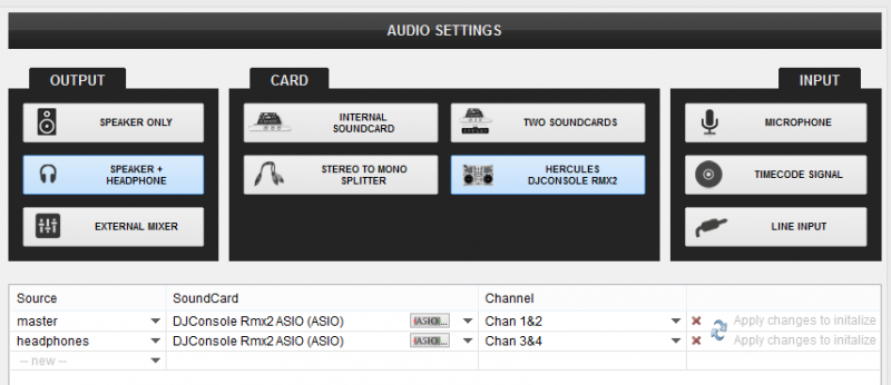

Regarding Virtual DJ:
- Remember that VDJ 8 is still being tweaked and corrected so some problems are to be expected.
- The basic audio configuration for the Rmx2 should look like this:
