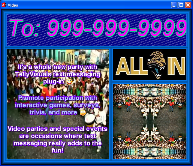

TellyVisuals capturing the VDJ video in the lower left and right panels. When you do this it become resizable. The bottom right is mirrored tiled. Just so happens I have TellyMedia playing the video in the background in this case. Could be anything providing the video but I like to use the best available.

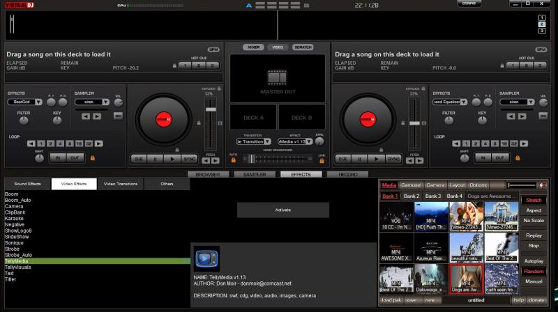

Thank you - I have to admit I am very sketchy about how all this IMU and Essential Media and Telly this and that are and what they do so I may have been probably looking at the wrong things when doing my searches and saw the costs I quoted. Web sites were down for a time and I did a quick search and (not even sure I was on the right site) i saw at first a cost of $300 then a drop down to $250 - probably this Pangolin site for not sure what. I am also not sure what does what other than IMU is a texty thingy and essential Media was a video thingy where I am simply looking to do something like clipbank in V8 before I can shift from V7 and have been frustrated as heck because VJ is really my bread and butter. I did manage to get Tellymedia and Tellyvisuals installed and somewhat working now in V7 but to be truthful I feel it is far more cumbersome than clipbank and Video Text (for now while I am learning capabilities) so it is nothing I could use at a gig until I figure it out more. I really like the Clipbank and Text engine in V7 as it is simple and a no frills tool that simply works. As for V8 - no clue how the Telly Sisters integrates to V8 at all and how to even activate the plugin as the interface is completely foreign from V7 with no "Effects" tab to go to that I can see anywhere - gotta say V8 gets a C- for intuitiveness...

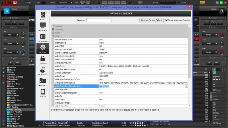

Stumbled across this post:
http://fr.virtualdj.com/forums/191728/General_Discussion/how_to__Set_this_plugin_to_run_for_audio_only_files___like_in_VDJ7___.html
Low and behold - moving the telly apps to visualizations folder seems to work. Only, how do I access the interface to change vids in the plugin like V7. It seems to remember the V7 settings I had set - right now I guess I have to use the interface in V7 to transfer settings to V8?

By George I think I gots it! - Not perfect but it is working on both accounts - both video and text! :-)

I do not recommend you move the TellyMedia or TellyVisuals dll's to the visualization folder at this time. I do not recommend using audio only visualizations in the automatic sense either for any effect but that is your choice. At this time, audio only visualizations are always on when the video window is shown. It does not depend on only audio files. It will increasee CPU usage since even when you play a video in VDJ since the audio only visualization will still be on playing in the background and can also cause problems you can read about here:
