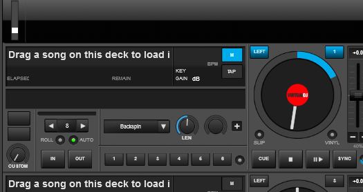

3. After unloading a song, the progress bar around the deck disk stays active
