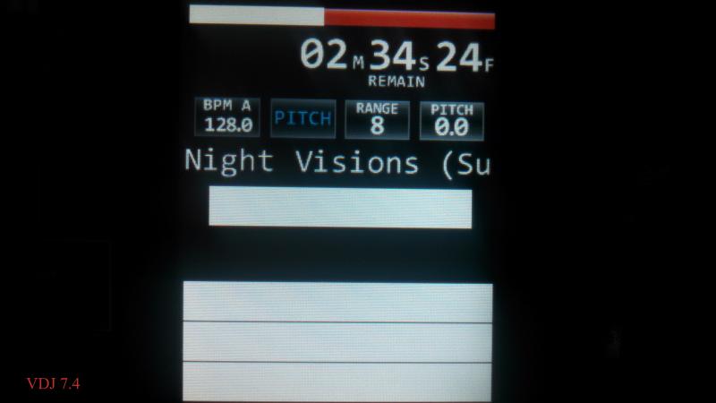

Hello,
I'm using my Gemini CDJ700's with virtual DJ, I've been using them for more than a year now, and with this new update I notice something that I would like to call a small glitch.

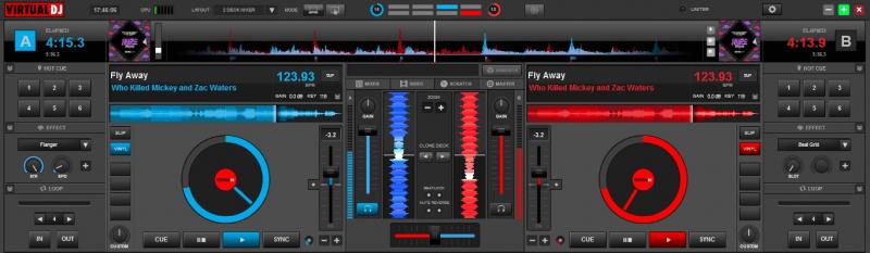

If you notice on this first image, I'm using VDJ7.4 and I can see the time remaining on my screen, but when I switch to VDJ8 I don't get time bar, why is that?
Can this be fixed, please.

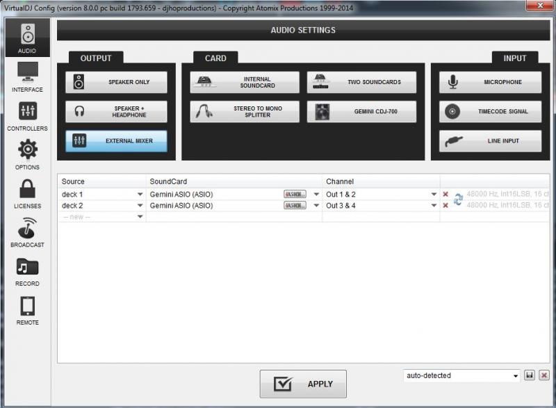

In addition, I'm having a hard time setting up the audio, my channels are inverted, and I noticed that I now have a GEMINI CDJ700 Audio WASAPI, what is wasapi?
Under vdj 7.4 I was able to set up the audio quite easily and if my channels were inverted, I had to do was to press the ejection button (while the cdj's are on MIDI mode) and problem solved, but not on VDJ8. Any suggestions. This is how I managed, just a few minutes ago, to set up my cdj's with vdj8;
I understand that if I press the save button, it will save my settings, and I tried, twice! but no luck, I have to turn both units off, then turn one on first, wait a few seconds, then turn the other one on, in order for them to work properly. HELP!

Looks like the same issue as the 650's - which has been reported.
http://www.virtualdj.com/forums/188578/VirtualDJ_8_Pro-Users_Forum/mapping_Gemini_CDJ_650.html

Can you please see if the Gemini ASIO is available in the drop down list of the Sound cards ? If not please make sure you visit the manufacture's webpage and install the latest available drivers.
If there is, then please make the correct audio setup (apparently as an external mixer with deck 1 and deck in the lines) and post a screenshot here.
For the time bar issue, yes , as stated above, it has been already reported and will be fixed soon.

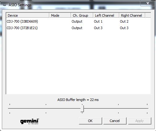

As per your request, I downloaded the Gemini ASIO drivers again, and it took me while to configure the settings until I remember the ASIO settings. Here are some of the screen shots. My mixer is set up for external whenever I use my CDJ's, it's only when I use my Hercules controller that I switch that particular setting.
I copy the ASIO settings I have on VDJ7.4 and applied it on VDJ8 and it works for now. Each channel loads up correctly, and sound comes out off the correct channels. I click the save button on the lower right hand side, and I will test it again tomorrow morning before my event.

If one of the devices is not detected one day and the next is, then maybe there is a "driver" issue... meaning that it wouldnt even show up correctly in Device Manager. So, please double check if this happens again.
Note, that if the unit is not properly detected by the OS, then apparently neither VirtualDj will be able to use the device and of course the audio Setup will not be available the way you ve set it.
PS. I checked again the definition files, and the asio name is correct, so the special button you see on the top of the Audio tab, should work and properly create an External Mixer Audio Setup with deck 1 and deck 2. Can you please double-check again ?
As for the inverted sides, i dont think we can do anything, meaning that once the order is set, next time you launch VirtualDj, it should keep that order, Unless !, you have unplugged the devices in between and plugged again in different order.
At any case, you can still swap the audio channels in the Audio Setup tab, using the red "cycle/swap" icon and either use the EJECT button on the CDJs to swap the MIDI control or even from the Controllers tab (assign deck list)

"If one of the devices is not detected one day and the next is, then maybe there is a "driver" issue... meaning that it wouldnt even show up correctly in Device Manager. So, please double check if this happens again.
Note, that if the unit is not properly detected by the OS, then apparently neither VirtualDj will be able to use the device and of course the audio Setup will not be available the way you ve set it."
If that's the case, then could you explain why Virtual Dj 7.4 reads both units, and responds perfectly fine?
"PS. I checked again the definition files, and the asio name is correct, so the special button you see on the top of the Audio tab, should work and properly create an External Mixer Audio Setup with deck 1 and deck 2. Can you please double-check again ?"
Tried it several times, I did exactly as you are telling me to do, and nothing.
"As for the inverted sides, i dont think we can do anything, meaning that once the order is set, next time you launch VirtualDj, it should keep that order, Unless !, you have unplugged the devices in between and plugged again in different order.
At any case, you can still swap the audio channels in the Audio Setup tab, using the red "cycle/swap" icon and either use the EJECT button on the CDJs to swap the MIDI control or even from the Controllers tab (assign deck list)"

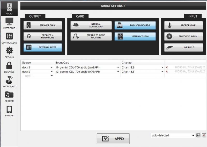

Okay, so I finally was able to set up my cdj's with VDJ8 to work correctly. It turns out, I was setting them as master- gemini asio- chan 1-2 and headphones-gemini asio- chan 3-4. Just now I set them up as:
and it worked just fine.
