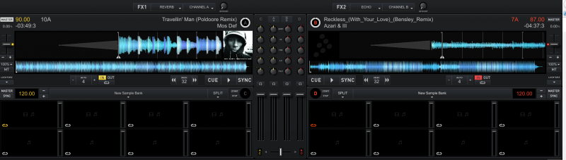

the option to have remix decks would be great or even something like this where is 8 sampler pads on a deck
