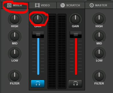

2. Select the mixer panel in the skin...there you can change the gain

Thank you, but the gain had been changed from the VDJ7, is it possible to recode the gain to match it with the same as VDJ7?

I'm not sure exactly what you mean by "the gain has been changed" but the output headroom can be adjusted with the zerodb config setting.
There also other gain related settings in the config (search 'gain').
Posted Sat 24 May 14 @ 4:33 am
Warning ! In V8 not disable Limiter
I recommend:
in settings .. Gain to AUTO
ZeroDB ... correct 0.70
I recommend:
Posted Sat 24 May 14 @ 5:44 am

groovindj wrote :
I'm not sure exactly what you mean by "the gain has been changed" .
The gain value in VDJ8 is louder than the gain value in VDJ7, it means the gain in VDJ8 was boost.
