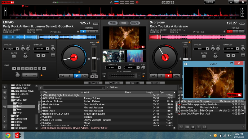

Well here I have a 2 vids, playing correctly, in both decks of the old VDJ7 2 deck skin, on VDJ8, with a deer head on the output. What is going on? LOL!
Posted Tue 20 May 14 @ 7:37 pm
Were you using a 4 deck skins previously - and is the other track loaded onto that?
Dan you may be right. I think I was playing with the VDJ8 4 deck skin, and then went to the old 2 deck skin. And as I have been trying 8, and different skins in it, there has been a few video glitches. I had no idea skins can overlap, if this is the situation. And if it is, how is it preventable?
Yes Dan, you are correct. The skins can overlap, but if I do not change skins, everthing runs fine. Switching back and forth seems to create the overlap. (I'm playing with my new toy!!) A simple fix, decide which skin you are going to play the night with, open 8 with that skin,and then don't mess with it. Thanks!
It's not the skins overlapping.
But you can in theory run 4 decks on a 2 deck skin.
No No, not goin' there Dan, I'll just get confused! LOL!
