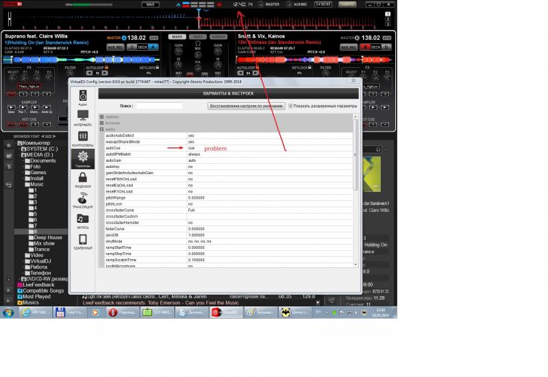

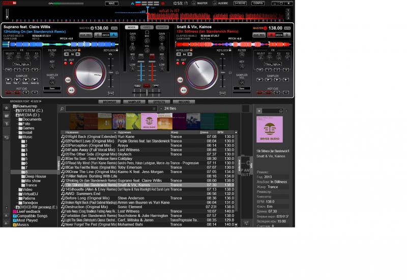

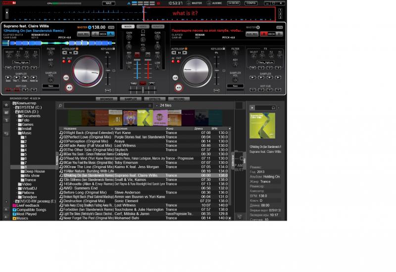

After downloading the entire track from the first Kia disappears waveforms. It started yesterday

any skin, even in the original 8

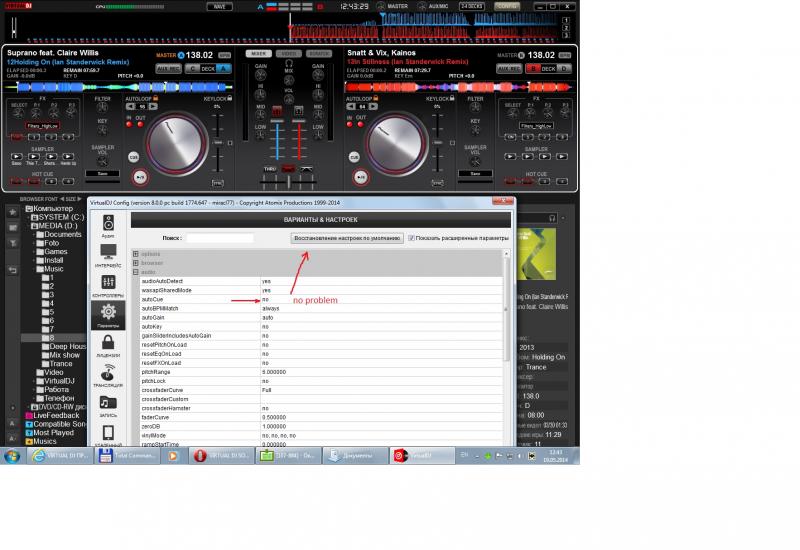

Posted Mon 19 May 14 @ 4:26 am
this problem is solved if the - settings - audio - autocue - no

At the moment i only can confirm it with tracks from iTunes ;-) normal MP4 files will shown fine.
