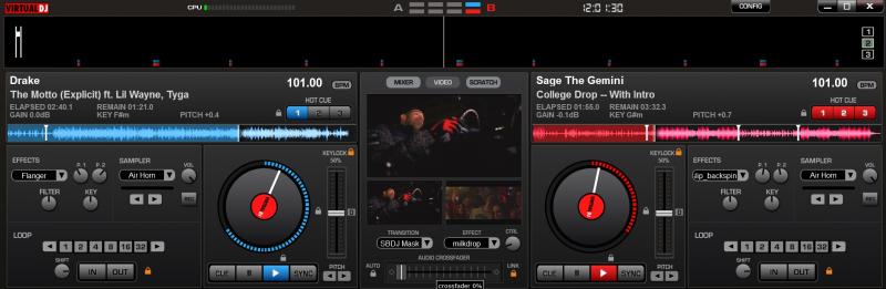

          Also, the waveform display is still a HUGE bug!!!
You'll notice there are 2 songs playing and NEITHER shows a waveform in the rhythm window!!!
       Posted Thu 22 May 14 @ 11:08 am

          Any ideas on the waveform issue? I can now repeat the glitch every time! I loaded a video ("Gossip Folks" by Missy Elliott), but moved the cursor into the file before the video was completely loaded. I started playing the track from that point. This caused the waveform from the point I started to disappear! However...the waveform up to that point is there! Worse yet...it's permanently that way! I tried it with another video...same problem!

          cant reproduce that other than the options setting I mentioned above..
Can you provide some details about your system? Specially the graphic card.
Double check again the skinDisableHWAccel in the options`? Set it to "no" .. make sure..
(and sorry, I see i wrote "yes" earlier, so please check again, it must be at "no" - do not disable hardware graphics for skin)
But looking closer at your screenshot, thats probably not it since you song pos waveforms looks good
Posted Thu 22 May 14 @ 2:40 pm
