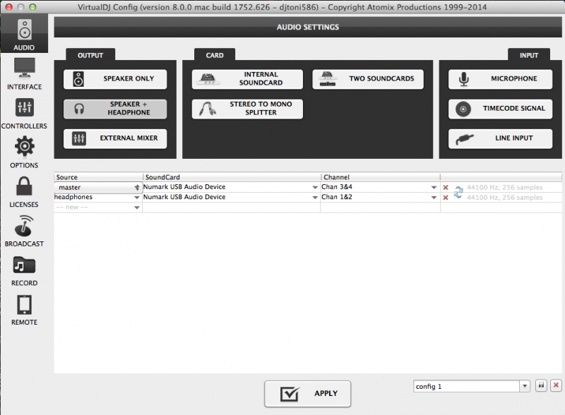

2. When i mix through headphones for cueing or at night when i cant play through my monitors the sound splits on to one side of the headphone. I can hear everything but its one sided and i have messed around yet again with the mappers to try and fix it but no result this is a screen shot below of my settings
Choose "internal soundcard" not the "stereo to mono splitter" option.
So i just hit restore to factory settings and both problems don't occur anymore thanks for the input Dj Toni 586 wrote :
Cheers !!!
