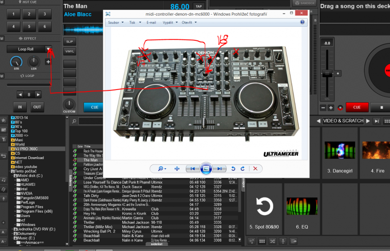

Beauty Denon MC6000 is gone....
knob change FX (classe FX1 or FX2 or param ) optimal in V7 but in V8 not work
Why in V8?
All changes with SEL. (select central knob in Denon mc6000)
Why in V8?

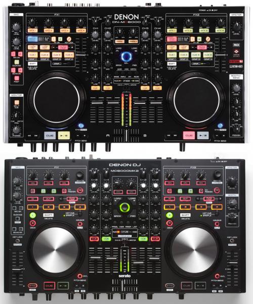

They want good support V8? go to the 6000 MK2
you need to change-effect jagged knob (MK2 FX )
