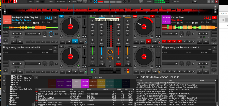

.png)
As you can see everything looks fine. However, this screenshot was taken during complete silence on the output both headphones and master.
All I did was load one song to deck 1, play it. Then loaded another song deck 2. Used the hot cues a few times. Mixed the track. In the middle of the mix I used the mouse to click on the video tab to see how the video was mixing. Then I clicked on the mixer tab and the sound went completely dead. The common factor in all cases seems to be when I use the mouse to do something on the skin.
I have still not tried this with my Hercules 4Mx, but the reloop is what I use at the night club, so I am extremely concerned that something like this can happen. I cannot even contemplate using version 8 until the dev team has isolated this bug and fixed it.
Ok I just tried to replicate what I said above, to see if there was some consistency and the same thing happened. When I clicked on the video tab while mixing, and then moused over the mixer tab, the sound died at the point when the tooltip appeared for the mixer tab. Please see if this can be sorted out.
Thanks!
Posted Wed 14 May 14 @ 2:48 pm

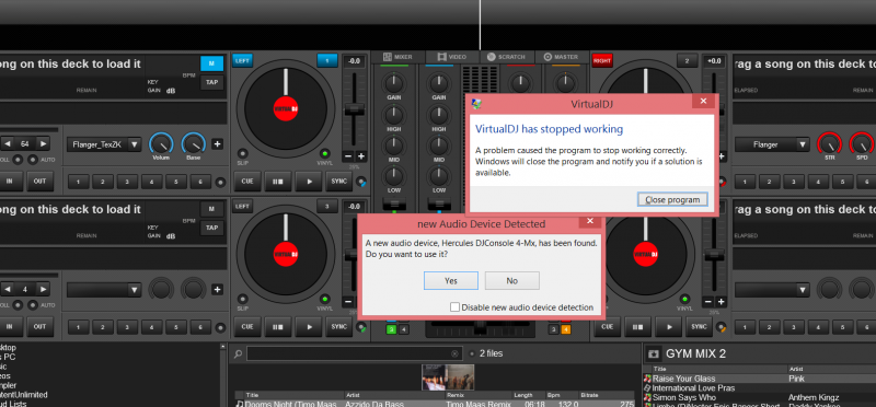

          Ok, so I tried to replicate with my 4mx. First thing I did to try and replicate it was connect the controller after starting virtual DJ. Then there is a notification stating that a new device has been found, do you want to use it? I clicked yes. This immediately caused the program to crash. Repeated this and the same things happened. Windows notification came up saying something has cause virtual dj to stop working and the program will be closed.
I have already update the firmware and drivers of the 4mx to the latest version.
Posted Sun 18 May 14 @ 3:25 am
          The 4MX issue (connecting device after launching VirtualDJ8) is probably fixed in the latest build (1774) Cant reproduce it anymore.
Please verify
    Please verify
