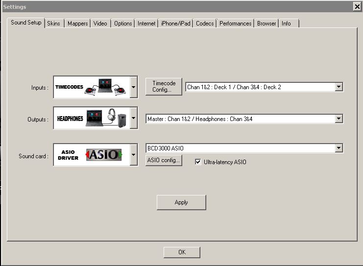

djtouchdan wrote :
Post the screenshot and i'll take a look.

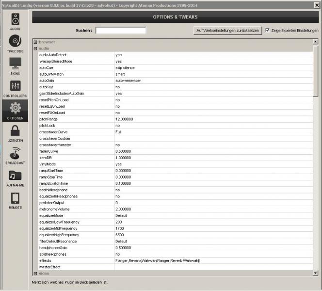

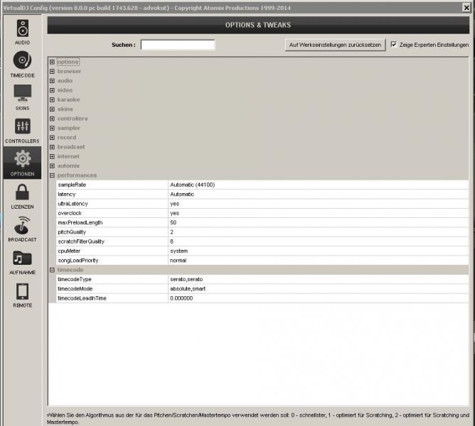

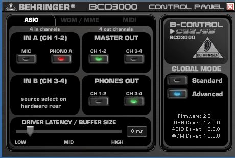

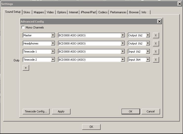

This is my advanced soundconfig in version 7.4 ( just noticed that i changed headphones by mistake. headphone is output 3+4) :

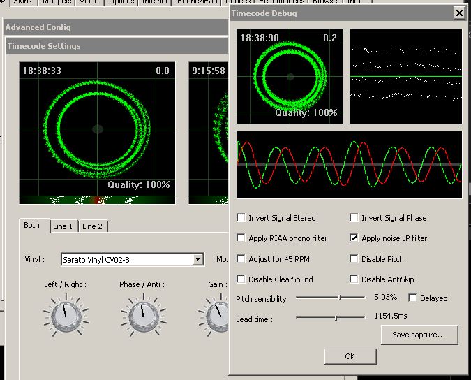

This is my version 7 timecode config:
This is my Behringer BCD3000 Control Center ASIO config

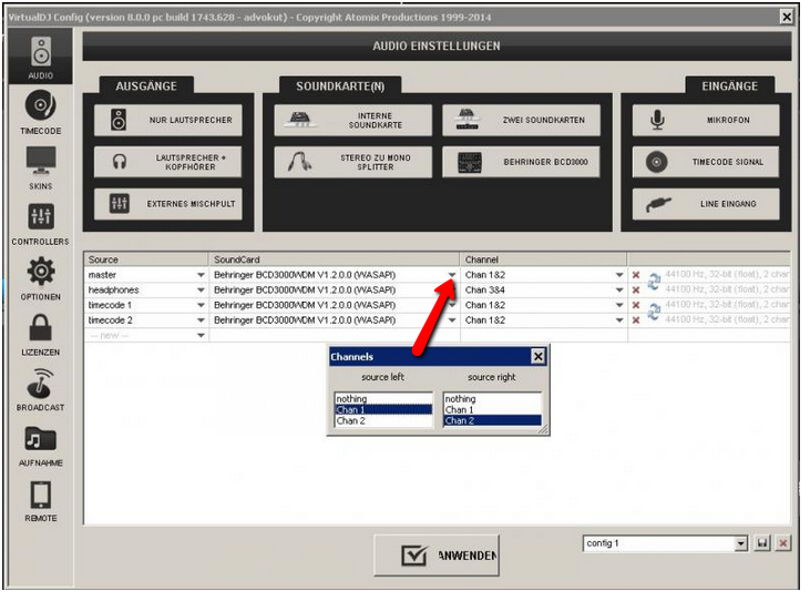

This is version 8 audiosetup panel, which shows the BCD3000 as WASAPI and not as ASIO unlike version 7:
These are the relevant adcanced options regards Audio, Performance and Timecode:
thank you for your help, can´t wait to get to use my TT´s
Posted Tue 13 May 14 @ 8:38 pm
          If you click on these arrows can you change to ASIO?
       Posted Tue 13 May 14 @ 8:40 pm
          tried to screenshot this setting, sadly it closed when switching to snipping tool.
I can NOT change it to ASIO. This is shown, can not screenshot with snipping tool sadly
-my internal soundcard(WASAPI)
-the bcd as shown on the screens
-my Native Instruments Audio2DJ (ASIO)
here´s another setting i can use flawlessly in v7 using the normal setup method and not the advanced config

          i have a question with the V8 setting...are any of those option highlighted, is the BCD option highlight i dont see if its selected
    Posted Wed 14 May 14 @ 1:48 pm
          you mean in the dropdown menu? yes the bcd is selected
    Posted Wed 14 May 14 @ 2:46 pm
          He's referring to the big buttons in the black boxes, for outputs, soundcards and inputs.
With certain Windows themes, the buttons don't get highlighted.
Posted Wed 14 May 14 @ 3:03 pm
          yes, there also selected there.
here's how i set up. i clicked bcd icon/button. clicked the timecode icon/ button on the right. i than erased the mic channel as i dont use one.
all channels (master,headphone and timecode) can only be set as BCD3000WDM(WASAPI) and timecode 1 and timecode 2 can only choose between nothing,chan 1 and chan 2 (left turntable input). chan 3 and chan 4 ( right turntable input) is missing.
also still missing is a option to choose the bcd's asio driver.
think that's it this far. thanks a lot for helping me
btw. i.noticed behringer released a newer version of the usb and audio drivers. my gig machine is on an older version which ran stable with vdj7. gonna update and see if this fixes the issue. will report back soon
Posted Wed 14 May 14 @ 3:24 pm
          its working...ITS WORKING!
I updated the bcd drivers and now i can change to ASIO and use both off my tt's. Just gave it a testrun juggling and scratching.
