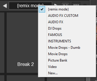

Right click:
Posted Mon 12 May 14 @ 11:29 am
Oh nicely hidden away.
IMO that mode should be available when clicking through the banks.
There seems to be a quantise applied somewhere, and changing the playback mode doesn't make any difference either.
No access to list view in Remix Mode, so no way to edit, change mode etc.
