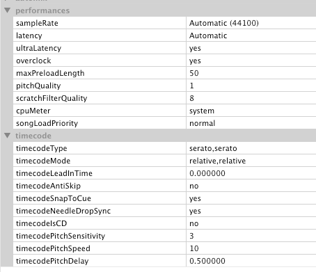

Never use pitch delay 0.00000
0.1000 was my settings at Bpm for a rapid pitch slider response but this is maybe an extreme setting.
Default is 0.5 so anything between 0.2 to 0.5 is a safer value. 0.2000 seems good so far to balance between speed and stability.

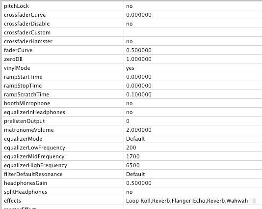

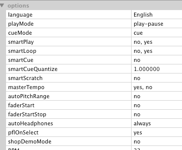

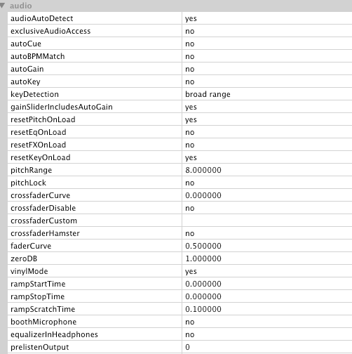

These are some of my settings, compare with yours and adjust where necessary to see if you can eliminate the problem.
