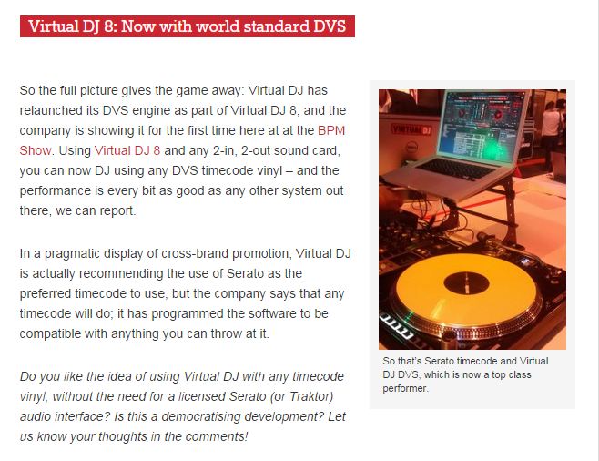

Hey guys,
Saw this on a blog today
Well done Virtual Dj
