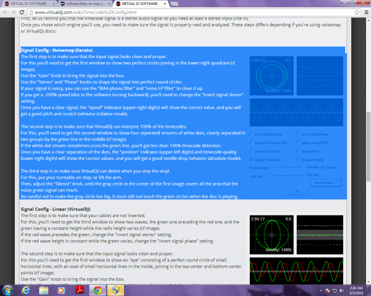

I see this is posted on VDJ TIMECODE page but we have none of this for VDJ 8
Options
Once you have a 100% timecode detection, you can adjust a few options to tailor the timecode engine to your liking.
Adjust for 45 RPM: select this if you prefer to scratch with your turntable set at 45 RPM (all timecodes are usually 33 RPM discs by default).
Disable Pitch / Pitch sensibility / Smooth: By default, VirtualDJ will interpret the movements of the pitch slider on the turntable, and translate this in movement of the pitch applied by the software.
This let you use features such as KeyLock or automatic BeatSync.
But, because of the intrinsic nature of the timecode technology, the software cannot clearly tell a pitch change from a scratch, so this pitch changing detection cannot be instantaneous.
These options give you control over the pitch detection sensibility. Adjust to your liking.
ClearSound: ClearSound was a technology used in older versions of the VirtualDJ linear engine, to suppress an "underwater" effect that was inherent to these particular engines when used at low latencies. Since the problem is not present in the newer engines, ClearSound is off by default. But you can turn it on if you use an older engine or still hear this underwater distortion.
AntiSkip: AntiSkip is a technology that lets the software automatically compensate to ignore skips if the needle skips to a nearby groove while scratching too hard (or if your turntable is picking up too much vibrations). It is active by default.
LeadTime: LeadTime is the amount of "dead air" at the beginning of the timecode, to ensure that the start of your MP3 matches a position on your timecode disc that already has a strong and identifiable timecode stream.
And leadtime does not even work on vdj 8
I do miss these extra tweaks we had back in version 7, they saved lives... The options are pretty limited where VDJ8 is concerned... let's keep this thread alive guys, we need to keep shouting
