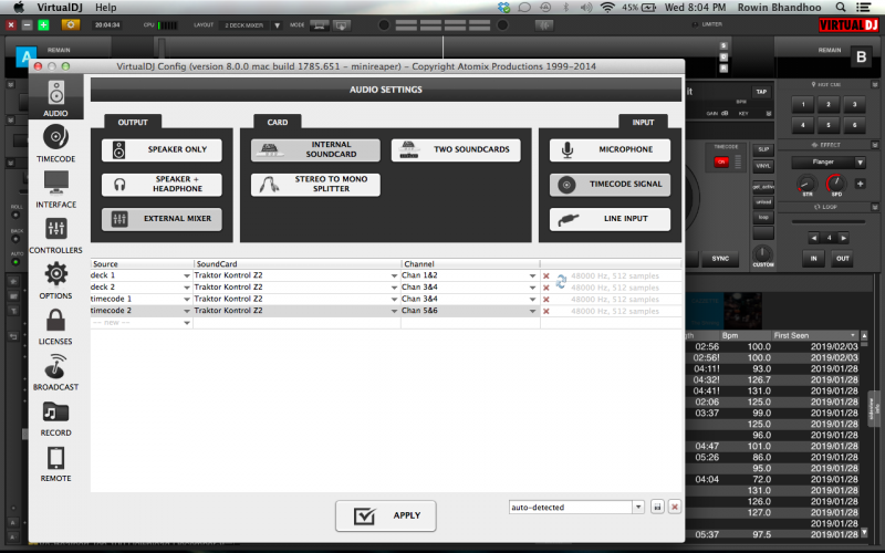

with this setting ..i can see both timecode signal clearly but i can only hear the left deck
with this setting ..i can see both timecode signal clearly but i can only hear the left deckyour timecode channels must be the same as the channel that you send the timecode in ex : if you send the left deck to channel 1 than your timecode channel will also be 1. channel 2 = 2 ....it needs to receive the timecode signal make sure that both timecode in the config receive a proper signal.
Posted Wed 21 May 14 @ 8:16 pm
Like this,
deck1 TKZ2 ch1/2
deck2 TKZ2 ch3/4
timecode1 TKZ2 ch1/2
timecode2 TKZ2 ch3/4
deck1 TKZ2 ch1/2
deck2 TKZ2 ch3/4
Posted Wed 21 May 14 @ 8:18 pm
no luck still bud..im thinking it has something to do with the z2 ..everything is going through 1 channel no matter how i change the settings. and the only way i can get to read both timecode signals is to change one of them to 5 &6 . but then again both sounds come out as one channel
Posted Wed 21 May 14 @ 10:18 pm

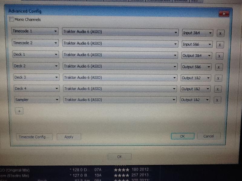

My Audio 6 uses channels 3&4 and 5&6. Input/output matching for each one. Output 1&2 are used with my CDJ400 on midi, not timecode.
Maybe setting yours like this will work.
Posted Wed 21 May 14 @ 11:12 pm

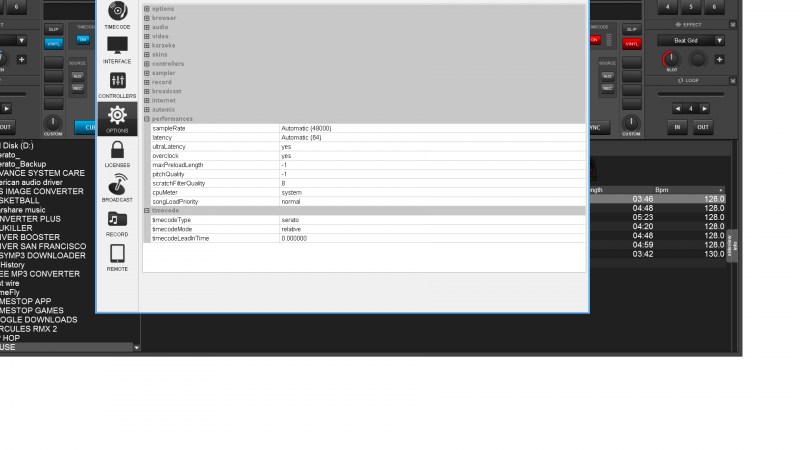

Amen i feel the same way but still waiting for a responds we need to control the timecode set up i posted a pic up and u look at vdj 8 for timecode set up it look like they did not care about us timecode user they just but it there.in vdj 7 u had control of timecode set up we need it back with vdj 8 touch.
