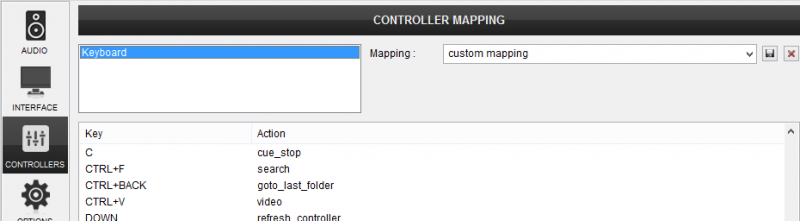

So in config -> controllers you only see keyboard?
correct?
correct?
Posted Sun 11 May 14 @ 6:14 pm

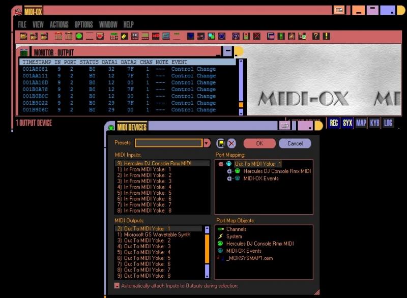

No, i have other selections.... MIDI Yoke
I found the problem, but it opened a new problem for me..... I use MIDI-OX to be able to use one controller for 2 MIDI programs - VDJ and Ableton....as in my VDJ7 setup VDJ audio is sourced out to ableton (using JackRouter) and then MIDI-OX program to use MIDI commands from the controller so the commands can be sent to both VDJ and ableton.... as soon as I shut off MIDI-OX and restart VDJ 8 ...the controller work, however that causes me to lose MIDI control within ableton since MIDI-OX is not running..... is there a workaround to this?!

awesome...im still trying solutions....i have MIDI Yoke:1 selected as the MIDI Controller for ableton.... Im trying to do the same with VDJ 8 now...but I think I'm gonna have to map it out....as I tried to copy the contents of the old RMX map into the save Custom MAP for MIDI Yoke:1 but after I edit the xml file and restart VDJ the custom map for MIDO Yoke:1 does not show up, just appears blank
Posted Sun 11 May 14 @ 6:29 pm
I dont have the RMX but tried with the RMX2. So MIDI-OX was running and the RMX2 was the selected devices for both In and Out. I could then launch version 7 or 8 and control the software at the same time. Not sure what your settings are .. Please post screenshots if possible for the setup of the applications you are using.
Posted Sun 11 May 14 @ 6:39 pm
Well I have MIDI-OX and MIDIYoke installed - as well as JACK Audio Router (but that for now is irrelevant)
Normally I started JackRouter and MIDI-OX first, then load VDJ and then Ableton...
Within MIDI-OX, Initial setup was; Select Device, Under MIDI Input Select RMX and under Output select MIDIYOKE1
Under VDJ7 I didnt have to do anything special but map the controller how I liked... however within Ableton I had to select MIDI Input as MIDIYOKE1
It seems when I load MIDI-OX before VDJ 8 ...MIDI-OX gets exclusive rights to the controller preventing VDJ 8 from connecting and Vice Versa MIDI-OX doesn't connect to the RMX
Provided screenshot is of MIDI-OX device selections
